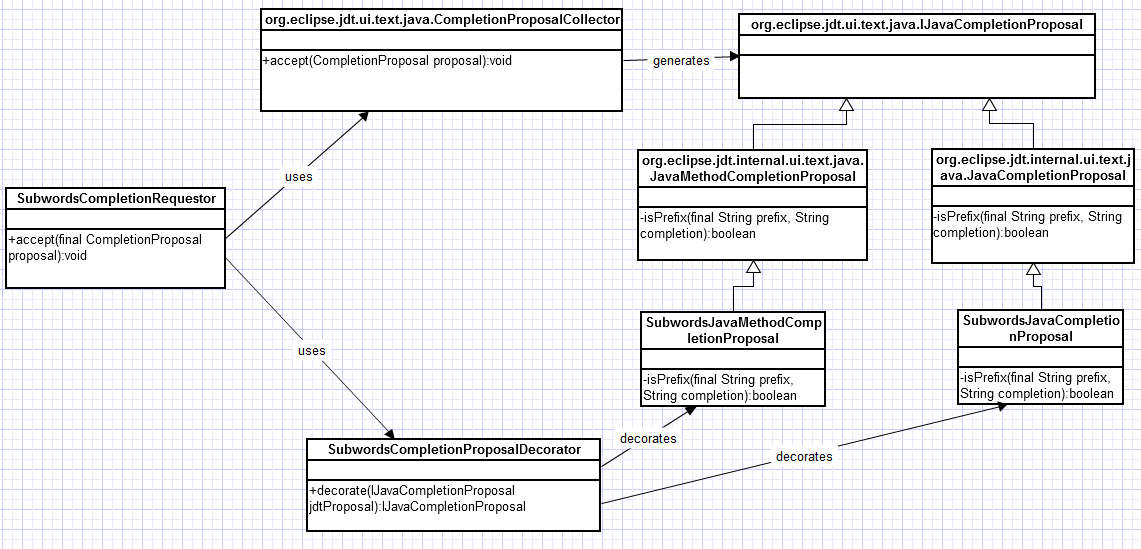

I started implementing a solution for subwords completion proposals (without having to copy the whole logic of org.eclipse.jdt.ui.text.java.CompletionProposalCollector.createJavaCompletionProposal(CompletionProposal) as you mentioned it).
Here is what I did :
- In SubwordsCompletionRequestor I call org.eclipse.jdt.ui.text.java.CompletionProposalCollector.createJavaCompletionProposal(CompletionProposal proposal) in order to get back the proper proposal, letting jdt make its job.
- In SubwordsCompletionRequestor I call a newly created SubwordsCompletionProposalDecorator that is used to decorate jdt proposal with our new isPrefix() implementation.
- Decorator instanciates all "Subwords proposals" extending jdt proposals with their own properties.
- And of course I made the decorator managing all proposal kinds returned by jdt collector.
After some tests, I think it is quite what we were looking for. So far, how can I provide you my snippets (in order to get your review)?
Cheers
Re: Contribution [message #674140 is a reply to message #674071] Wed, 25 May 2011 18:54 Go to previous messageGo to next message
Hi Paul-Emmanuel,
this sounds great - but #isPrefix was originally a protected method I made public for testing. AFAIK this method is called from "this" only. Could you verify that completion also works when you trigger completion after typing, say, just one character and then continue typing and verify that the proposals are refined?
Re: Contribution [message #674410 is a reply to message #674140] Thu, 26 May 2011 16:24 Go to previous messageGo to next message

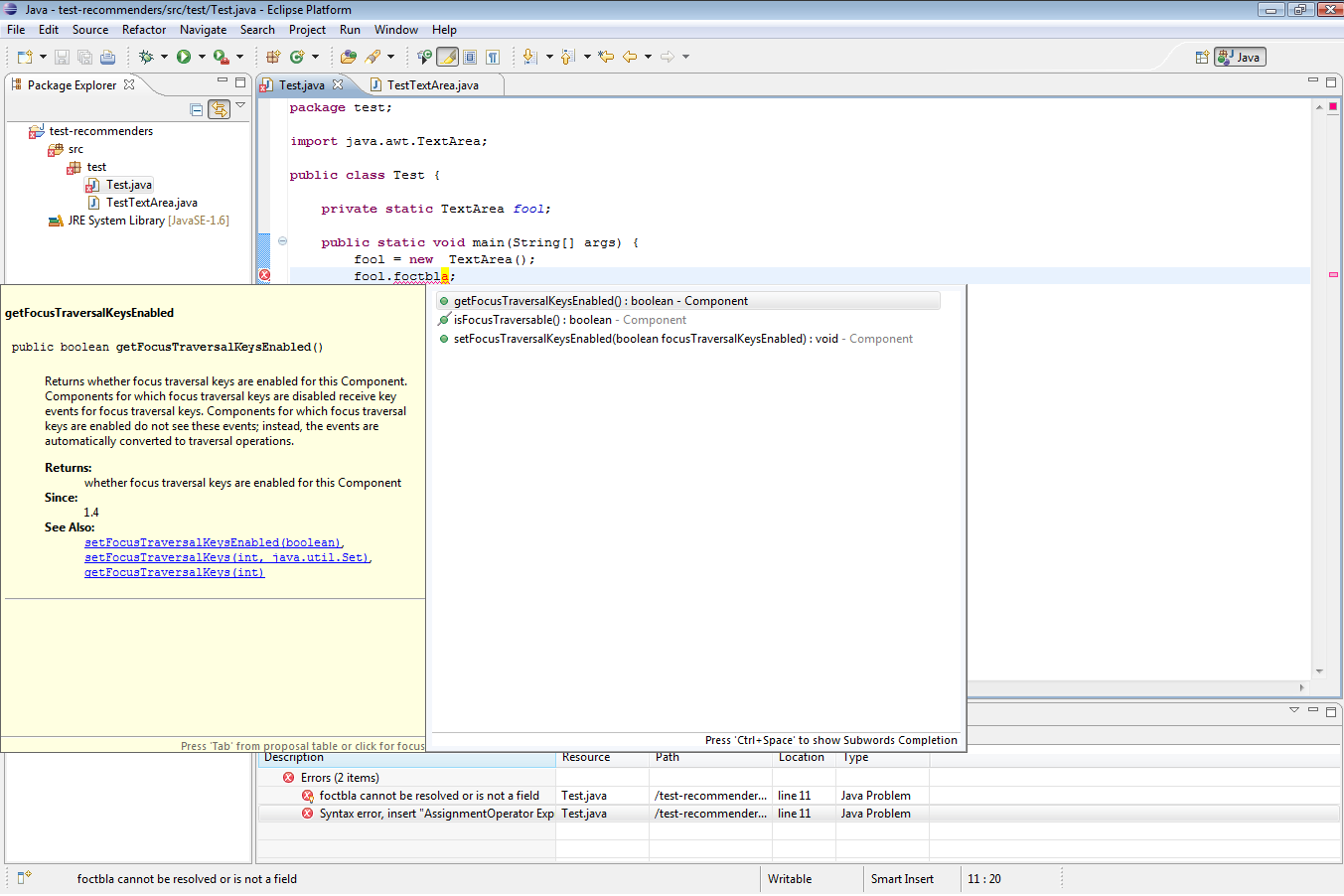

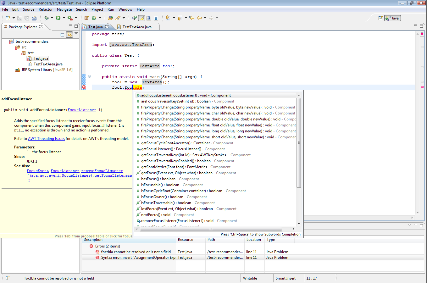

Hi Marcel,
I did some more tests and I can confirm that completion is still refined when typing or using left/right arrow keys. Also, isPrefix() is still protected, as overriding jdt completion proposal types method (so far, RegexMatcherTest does not compile anymore, but I may fix it later).
I drew you a simple class diagram trying to explain my implementation choices.
I also join two screenshots of running completion.
Please keep me informed if I missed something.
Re: Contribution [message #674421 is a reply to message #674410] Thu, 26 May 2011 17:03 Go to previous messageGo to next message
Hey Paul-Emmanuel,
that sounds good. Could you create a new bug report and attach your changes as patch (e.g., by using git-format-patch)? Then we can download and test your patch.
I'm looking forward to it!
Marcel
