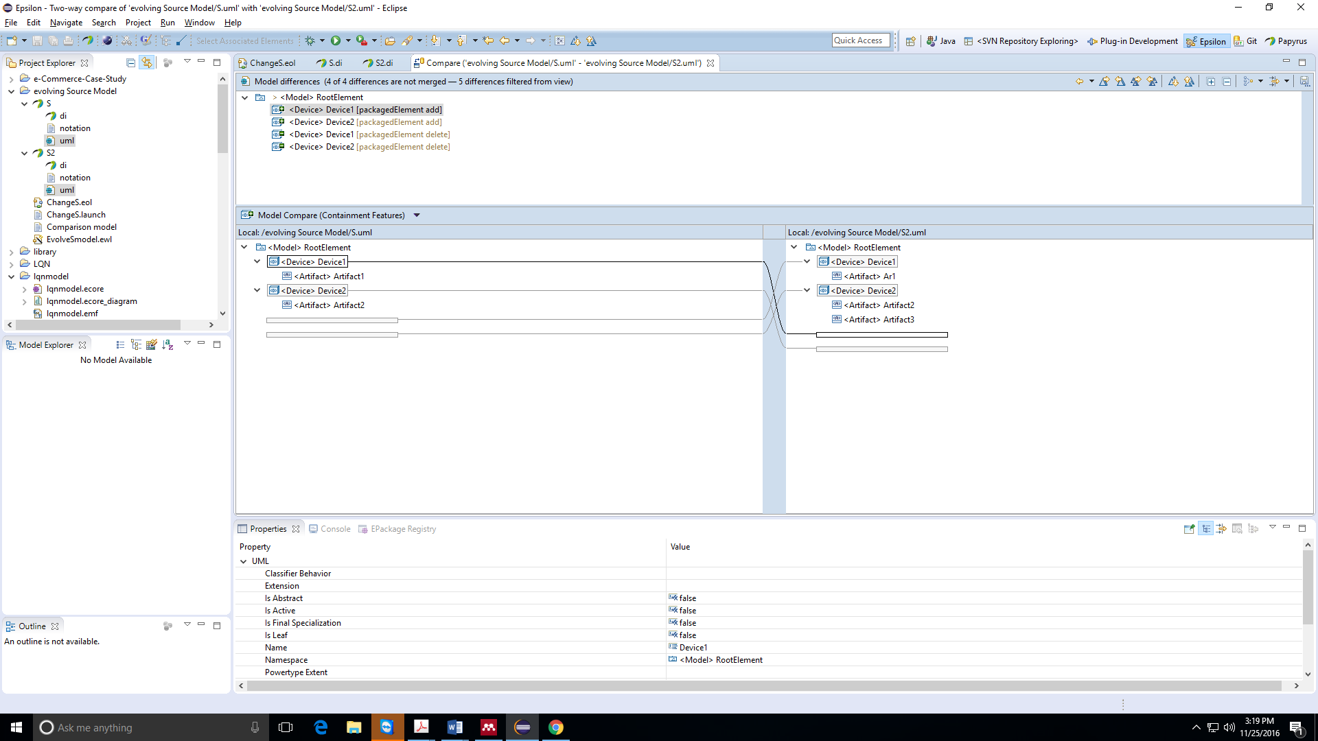

I am using Papyrus Mars on Epsilon and i used Compare with each other option to compare two UML models.For example
If i have two deployment diagram S1,S2
S1Model has device1 and has one artifact
S2Model which represents S1Model with changes such as adding new device let say device2 and then adding new artifact to device1.
So the changes should be :
adding new device device2(packagedElement)
adding new artifact to device1 (nestedClassifier)
When i applied compare with each other i got what is in the picture below (compare with each other)
I don't know if that is the correct way to do comparison and register every change that i have made because i think this is considered two different models with different IDs??

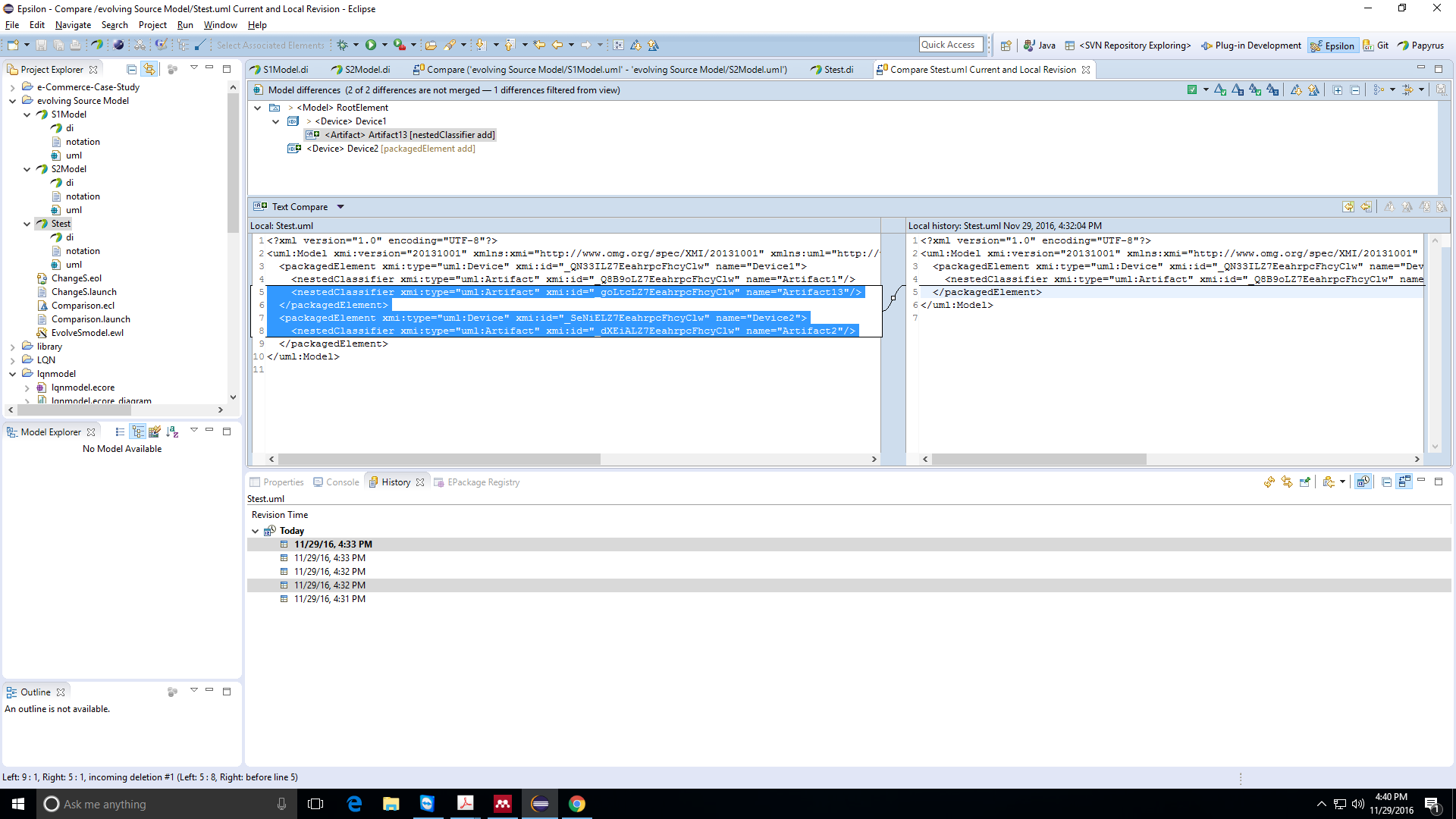

Also I tried to change the model itself ( Stest) i tried to see set of changes i have made so i used compare with local history then the problem that i got that i cannot get the whole changes all at once ,i got group of changes after each save and therefore i need to remember the first state of my model before change and follow each date and time to every change that i made which is not practical,

did you attach the correct screenshots? To me, both look equal.
You are using XMI:IDs and, I assume, the IdentityBasedMatcher will be used. Thus, you have to make sure that you only compare two versions of the same model (one is a modification of the other). Because if you compare two independent models, which have the same content, but which have been created separately, the models will have different XMI:IDs and, hence, will not be matched as you expect it. For the IdentityBasedMatcher, different XMI:ID means different EObject, means deletion/addition.
You could try to use git and the builds from collaborative-modeling.org (update sites [1] and [2]). This way you can create commits/branches that contain different states of your model in your git repo, which would allow you to compare those different branches (right-click on the model, compare with, Branch, ...).
