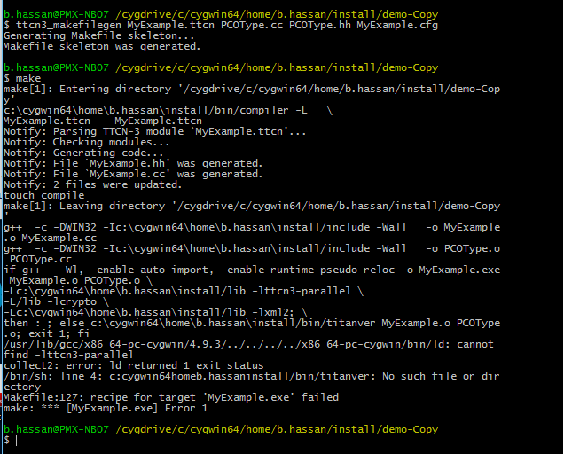

I agree with Elemer, the settings of environment variables are faulty.
From your make log this line is interesting:
"/bin/sh/: line 4: c:cygwin64homeb.hassaninstall/bin/titanver"
It seems that the "/" characters disappeared.
Check them not only in the cygwin environment but in the windows environment as well ! Especially the PATH env var. (I suppose the mistake is on cygwin level as Elemer said.)
BR
Jeno

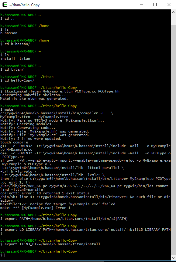

Re: Cannot make Demo Example from Titan [message #1714175 is a reply to message #1714095] Tue, 10 November 2015 08:47 Go to previous messageGo to next message
I tried to change the Env Variables, as you said and shown in the image "EnvVariable.PNG",
i re started my PC and tried to generate make file, but this time it said "command not found", shown in image "After ChangingEnvVariable".. I also updated the Windows Env Variables as you said.
I think the problem was of writing "titan.core" instead of "titan" (also removed from Windows Env Variables)... So set the variables again after removing ".core", and tried to make file again, but the same old error raised.
My Directory is.. :
C:\cygwin64\home\b.hassan\install (have bin,demo,etc,help,include,lib and man folders)
C:\cygwin64\home\b.hassan\titan
I thought this info can be helpfull...
According to above directories and "Installation guide" came with Titan package, i think my TTCN3 Directory is "C:\cygwin64\home\b.hassan\install"..So in setting Env Variables, i tried with "install" in place of "titan" as well, but of no use.
NOTE: I followed this video "Install ttcn3 on windows using eclipse titan" from You tube to set up Titan, and at time "30:50", it is setting env variables..
Hope i explained the problem i m in ..
Burhan

and when i make the example :
b.hassan@PMX-NB07 ~/install/demo-Copy
$ ttcn3_makefilegen MyExample.ttcn PCOType.hh PCOType.cc
Generating Makefile skeleton...
Makefile skeleton was generated.
$ make
C:\cygwin64\home\b.hassan\install/bin/compiler -L   \
MyExample.ttcn  - MyExample.ttcn
Notify: Parsing TTCN-3 module `MyExample.ttcn'...
Notify: Checking modules...
Notify: Generating code...
Notify: File `MyExample.hh' was generated.
Notify: File `MyExample.cc' was generated.
Notify: 2 files were updated.
touch compile
g++  -c -DWIN32 -IC:\cygwin64\home\b.hassan\install/include -Wall   -o MyExample.o MyExample.cc
g++  -c -DWIN32 -IC:\cygwin64\home\b.hassan\install/include -Wall   -o PCOType.o PCOType.cc
if g++   -Wl,--enable-auto-import,--enable-runtime-pseudo-reloc -o MyExample.exe MyExample.o PCOType.o \
-LC:\cygwin64\home\b.hassan\install/lib -lttcn3-parallel \
-L/lib -lcrypto \
-LC:\cygwin64\home\b.hassan\install/lib -lxml2; \
then : ; else C:\cygwin64\home\b.hassan\install/bin/titanver MyExample.o PCOType.o; exit 1; fi
/usr/lib/gcc/x86_64-pc-cygwin/4.9.3/../../../../x86_64-pc-cygwin/bin/ld: cannot find -lttcn3-parallel
collect2: error: ld returned 1 exit status
/bin/sh: line 4: C:cygwin64homeb.hassaninstall/bin/titanver: No such file or directory
Makefile:127: recipe for target 'MyExample.exe' failed
make: *** [MyExample.exe] Error 1
and the error remains...

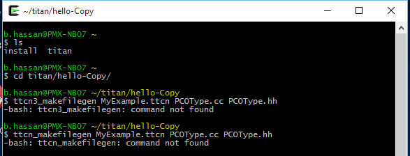

I can make it, but cannot execute, although previously i was able to execute the example which came with package..
Burhan

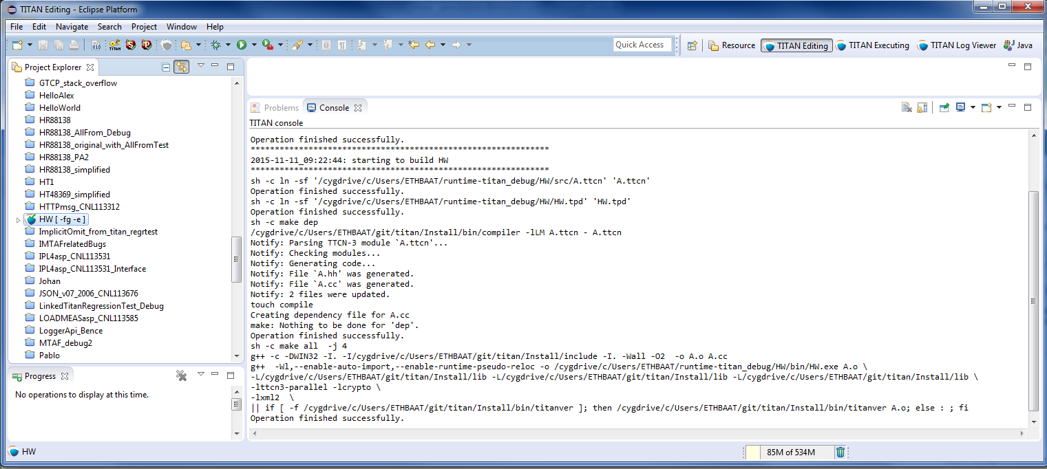

Eclipse is independent from cygwin. Eclipse use cygwin for build and for execution. Its method that Eclipse Titan plugin starts a cygwin command "sh -c <any cywin command>". In this shell your cygwin environment will be set first then the program will start. You can check it from Eclipse, from the console view. For example:
sh -c ln -sf '/cygdrive/c/Users/ETHBAAT/runtime-titan_debug/HW/src/A.ttcn' 'A.ttcn'
Operation finished successfully.
( see attachment)index.php/fa/23892/0/

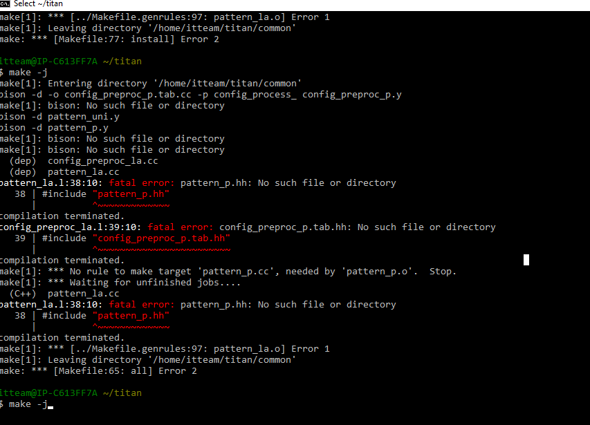

Hi Guys,
I am getting below error when i am run the titan compiler.
Environment path
PATH C:\cygwin64\bin;C:\cygwin64\home\itteam\install\bin
TTCN3_DIR=C:\cygwin64\home\itteam\install
LD_LIBRARY_PATH=C:\cygwin64\home\itteam\install\lib
C:\cygwin64 command:
tteam@IP-C613FF7A ~/titan
$ make -j
Makefile.personal
TTCN3_DIR := C:\cygwin64\home\itteam\install
OPENSSL_DIR := /usr
JDKDIR := /etc/java-config-2/current-system-vm
XMLDIR := /usr
JNI := yes
GEN_PDF :=no
Error logs:
make[1]: Entering directory '/home/itteam/titan/common'
bison -d -o config_preproc_p.tab.cc -p config_process_ config_preproc_p.y
make[1]: bison: No such file or directory
bison -d pattern_uni.y
bison -d pattern_p.y
(dep) config_preproc_la.cc
(dep) pattern_la.cc
pattern_la.l:38:10: fatal error: pattern_p.hh: No such file or directory

Re: Not able to clean ttcn3 project in Eclipse titan [message #1827210 is a reply to message #1827209] Sun, 10 May 2020 12:39 Go to previous message
Hi Ganesh,
your Cygwin installation is incomplete or wrong
(for instance the pre-requisite bison parser is missing or it cannot be found);
please check this post
https://www.eclipse.org/forums/index.php/t/1103718/
