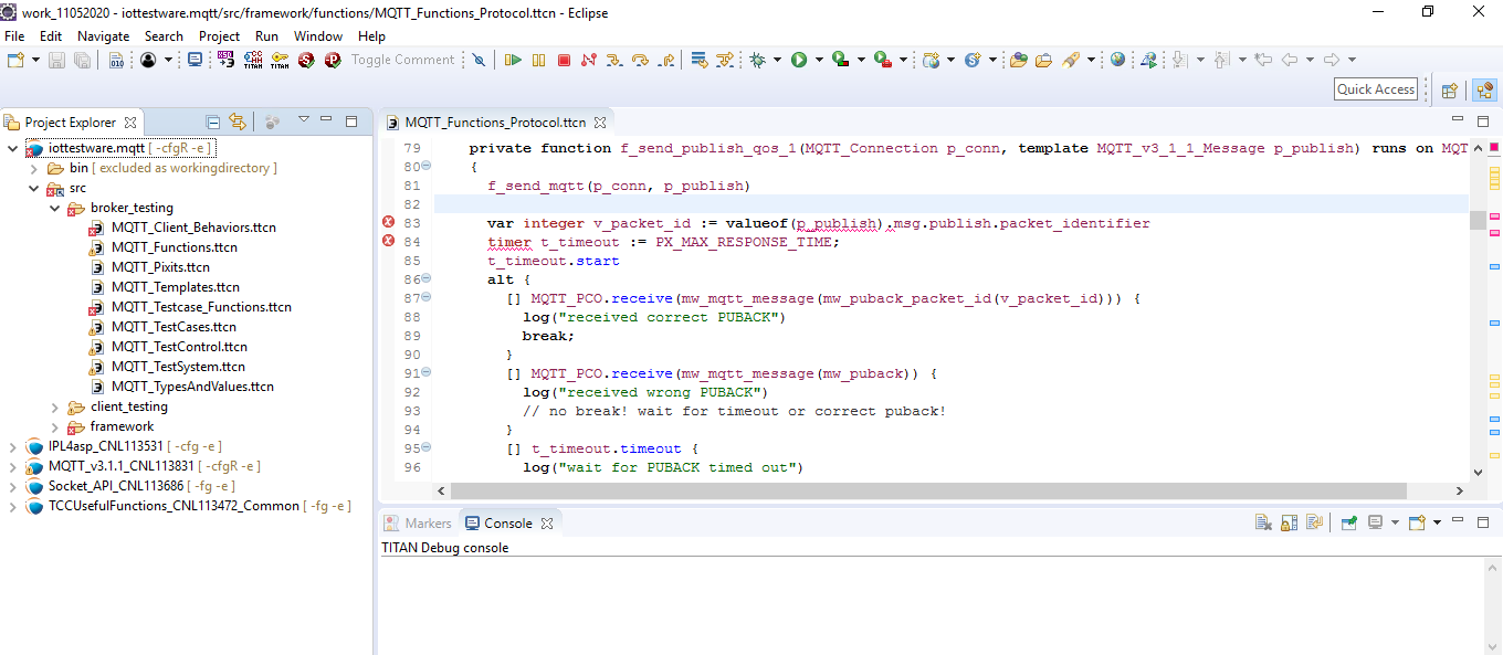

Hi Guys,
I am configure the Iottestware Manual Installation project to my local environment on Latest version of Eclipse Titan. but i am facing some issue please help me.
I have install the python in my windows system and run the below script.
protocol command:-
python install.py -p mqtt
python install.py --protocol mqtt
build command:-
python install.py -p mqtt -b
python install.py -p mqtt --build
After run the above command python clone the below project
IoT-Testware
Libraries
ProtocolModules
TestPorts
When i import the project on eclipse iottestware.mqtt.tpd file then we are getting some issue & i have also attach the eclipse project snapshot please give me some suggestion to remove the error logs.

Re: TITAN installation tutorial video for Windows with compiling on Cygwin. [message #1827290 is a reply to message #1827289] Tue, 12 May 2020 06:19 Go to previous messageGo to next message
Hi Ganesh,
I think you should open a separate topic with a title that indicates the subject that is IOTTestware.
Else it will not be read by those who are in the know.
Your question is not strictly related to Titan install on Windows.
BR
Elemer

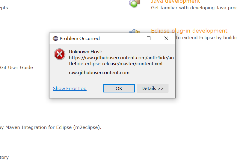

When I install the ANTLR,there is an error"Unkonwn host" see the attachment.
If I use the eclipse for C/C++ user,is it neccesary to install ANTLR?
BR

Re: TITAN installation tutorial video for Windows with compiling on Cygwin. [message #1827526 is a reply to message #1827524] Sun, 17 May 2020 08:16 Go to previous messageGo to next message
Hi Didi,
if you don't install ANTLR, the Eclipse IDE (and the stand-alone JAVA compiler/executor ) will not work,
so you can use Titan only from command line, assuming that the C/C++ compiler/executor installation was successful (and of course you will need a separate editor/IDE to create/edit etc. your TTCN-3 files).

Re: TITAN installation tutorial video for Windows with compiling on Cygwin. [message #1827709 is a reply to message #1827524] Thu, 21 May 2020 05:17 Go to previous message
Hi Didi,
The zip file for the eclipse plugins (on the download site) should contain all necessary dependencies (that do not come with eclipse itself).
Could you give us more information on how or why the installation tried to reach out for that host (raw.githubusercontent.com...)?
I have not seen this behavior yet, but maybe we can fix it, if it is an issue on our side.
