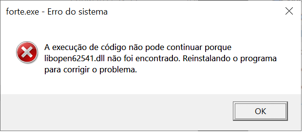

I'm studing 4diac for a while and I would like to use OPC-UA for one project. I followed the steps at the tutorial below:
https://www.eclipse.org/4diac/en_help.php?helppage=html/communication/opc_ua_version1.html
It seems everything was correct, it built the source files of FORTE and for the open62541 as well. But if I try to launch FORTE it stops immediately. If I execute the forte.exe I got an error informing the libopen62541.dll is missing (see image attached).
At the tutorial I notice that the file is named "open62541.dll". However in my case the file was created with the name libopen62541.dll. At CMake I inserted the path and the name acording to my case.
FORTE_COM_OPC_UA_INCLUDE_DIR=C:\Users\USER\4diac\open62541\build
FORTE_OPC_UA_LIB=libopen62541.dll
FORTE_COM_OPC_UA_LIB_DIR=C:\Users\USER\4diac\open62541\build\bin
Does anyone have any clue how to solve this? Any help will be highly appreciated.
thanks in advance
Rech
Re: OPC-UA open62541 missing .dll [message #1844842 is a reply to message #1844814] Mon, 27 September 2021 14:33 Go to previous messageGo to next message
normally the dll has to be either on the path or in the same directory as your forte.exe.
BR,
Alois
Re: OPC-UA open62541 missing .dll [message #1844991 is a reply to message #1844842] Fri, 01 October 2021 22:11 Go to previous messageGo to next message
Great!
add the .dll files to the forte.exe path and now it is running fine.
Thanks a lot Alois!

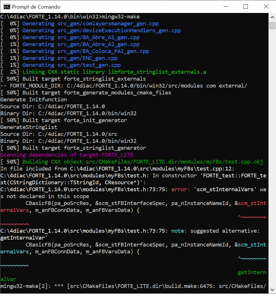

Thanks once again for the fast feedbacks. Looking forward for v 20.0.1. But while it is not released I'm testing some other versions of FORTE and with the 1.14.0 the OPC-UA ran and was also possible to compile some of my FBs. However, the FBs that use internal var at the ECC do not compile. See error message below (also available at the attached image).
Is there some way to correct it? I think that with this solved I'll have the needed environment to carry on with my research.
[ 50%] Building CXX object src/CMakeFiles/FORTE_LITE.dir/modules/myFBs/test.cpp.obj
In file included from C:\4diac\FORTE_1.14.0\src\modules\myFBs\test.cpp:12:
C:\4diac\FORTE_1.14.0\src\modules\myFBs\test.h: In constructor 'FORTE_test::FORTE_test(CStringDictionary::TStringId, CResource*)':
C:\4diac\FORTE_1.14.0\src\modules\myFBs\test.h:73:75: error: 'scm_stInternalVars' was not declared in this scope
CBasicFB(pa_poSrcRes, &scm_stFBInterfaceSpec, pa_nInstanceNameId, &scm_stInternalVars, m_anFBConnData, m_anFBVarsData) {
C:\4diac\FORTE_1.14.0\src\modules\myFBs\test.h:73:75: note: suggested alternative:
getInternalVar'
getInternalVar
mingw32-make[2]: *** [src\CMakeFiles\FORTE_LITE.dir\build.make:6475: src/CMakeFiles/FORTE_LITE.dir/modules/myFBs/test.cpp.obj] Error 1
mingw32-make[1]: *** [CMakeFiles\Makefile2:2024: src/CMakeFiles/FORTE_LITE.dir/all] Error 2
mingw32-make: *** [Makefile:129: all] Error 2
Re: OPC-UA open62541 missing .dll [message #1847551 is a reply to message #1847542] Mon, 01 November 2021 06:33 Go to previous messageGo to next message
Hi Ricardo,
please don't use 4diac FORTE 1.14.0 any more. There are some important fixes in 4diac FORTE 2.0.0. I did miss in your messages above any issues you had with 4diac FORTE 2.0.0 and OPC UA. We didn't change anything on the OPC UA code and our test builds run against OPC UA so 4diac FORTE should work just fine with with 4diac FORTE 2.0.0.
Cheers,
Alois

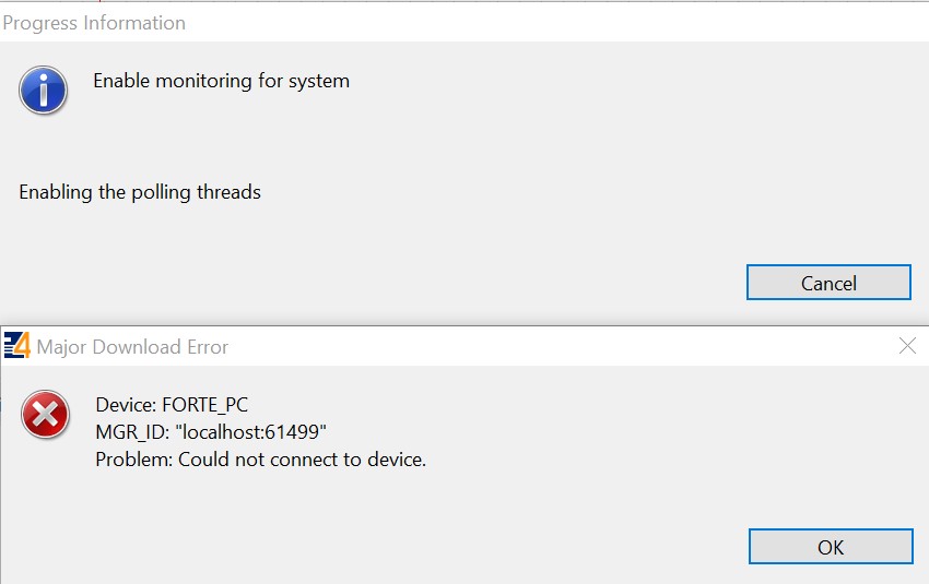

Now I'm facing some challenge to deploy the App (sorry to disturb you with all this questions). After launch FORTE and give the Deploy command I got an error informing "Could not connect to the device" (see attached image).
Did some further testes and if forte.exe is executed manually and then Deploy command it seems to work, however "Monitor System" don't work.
Any clue how to solve this?
Thanks for your patience
B.R.
Ricardo
Re: OPC-UA open62541 missing .dll [message #1847764 is a reply to message #1847758] Sat, 06 November 2021 16:38 Go to previous messageGo to next message
just to clarify: Deploy is not automatically starting a 4diac FORTE. This would be not the typical use case. The typical use case is that 4diac FORTE is running on the devices, and 4diac IDE would connect to these and deploy on them.
Regarding your monitoring issue. Can you give more info what is not working. Also for clarification when you enable monitoring 4diac IDE is not automatically showing any values. The reason for that is that you could have a highly distributed system with many devices and monitoring everything could put quite some load on the network. Therefore in 4diac IDE you have to select the FBs and pins you would like to watch and select add watch from the context or debug menu.
I'm happy to help. Sorry the 4diac is giving you such a hard time.

Re: OPC-UA open62541 missing .dll [message #1847837 is a reply to message #1847764] Tue, 09 November 2021 20:43 Go to previous messageGo to next message
Hi Alois,
For these first tests using 4diac and FORTE version 2.0.0 I'm running with FORTE_PC locally (no distributed automation yet).
In short, I want to be sure that both OPC-UA and FBs with internal var will run at the same framework. So, my app is the OPC-UA tutorial together with FB test.fbt I've sent previously here in the forum.
I believe the video below with the error when deploying FORTE shall clarify a bit:
https://www.youtube.com/watch?v=1C9L9vTiVrs
Also find attached the erros logs.
B.R.
Ricardo
Re: OPC-UA open62541 missing .dll [message #1847842 is a reply to message #1847837] Wed, 10 November 2021 02:32 Go to previous messageGo to next message
thx for letting us know. I'm not very happy with the current state of the simulated device manager. I'm not perfectly sure what the exact problem is here. However the Simulated device manager tries to stop all runtimes when you close it. I think for your experiments it makes more sense that you run your 4diac FORTEs without it directly from the console. If you just run forte.exe it will be bound to port 61499 if you want to specify a port you can do this with a parameter '-c: localhost:61500' without the single quotes.
I have some ideas to improve the simulated device manager. But they are currently not my top priority.

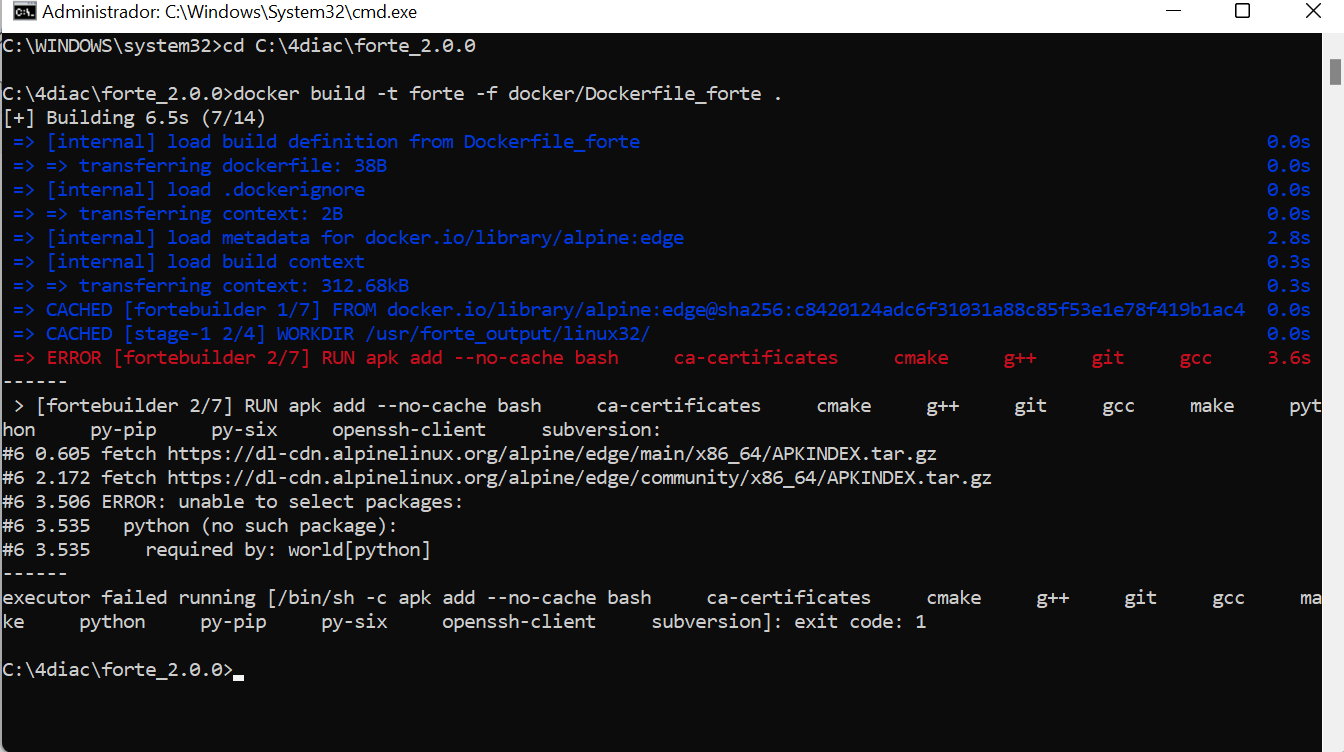

Hi Alois and 4diac community,
Many thanks for the reply.
But where exactly should I enter the parameter '-c: localhost:61500'?
Also, I've tryed to Build a 4diac FORTE docker image, as the tutorial below:
https://www.eclipse.org/4diac/en_help.php?helppage=html/installation/docker.html
But I got the error below (see complete description on the image):
ERROR [fortebuilder 2/7] RUN apk add --no-cache bash ca-certificates cmake g++ git gcc
Does anyone got a similar error?
index.php/fa/42048/0/
Re: OPC-UA open62541 missing .dll [message #1852286 is a reply to message #1852283] Sun, 08 May 2022 17:05 Go to previous message
Hi Ricardo,
when you start 4diac FORTE from the command line you can give this as command line parameter. However I just noticed I made a slight mistake. Correct would be
 ./forte -c localhost:61500
Cheers,
Alois
