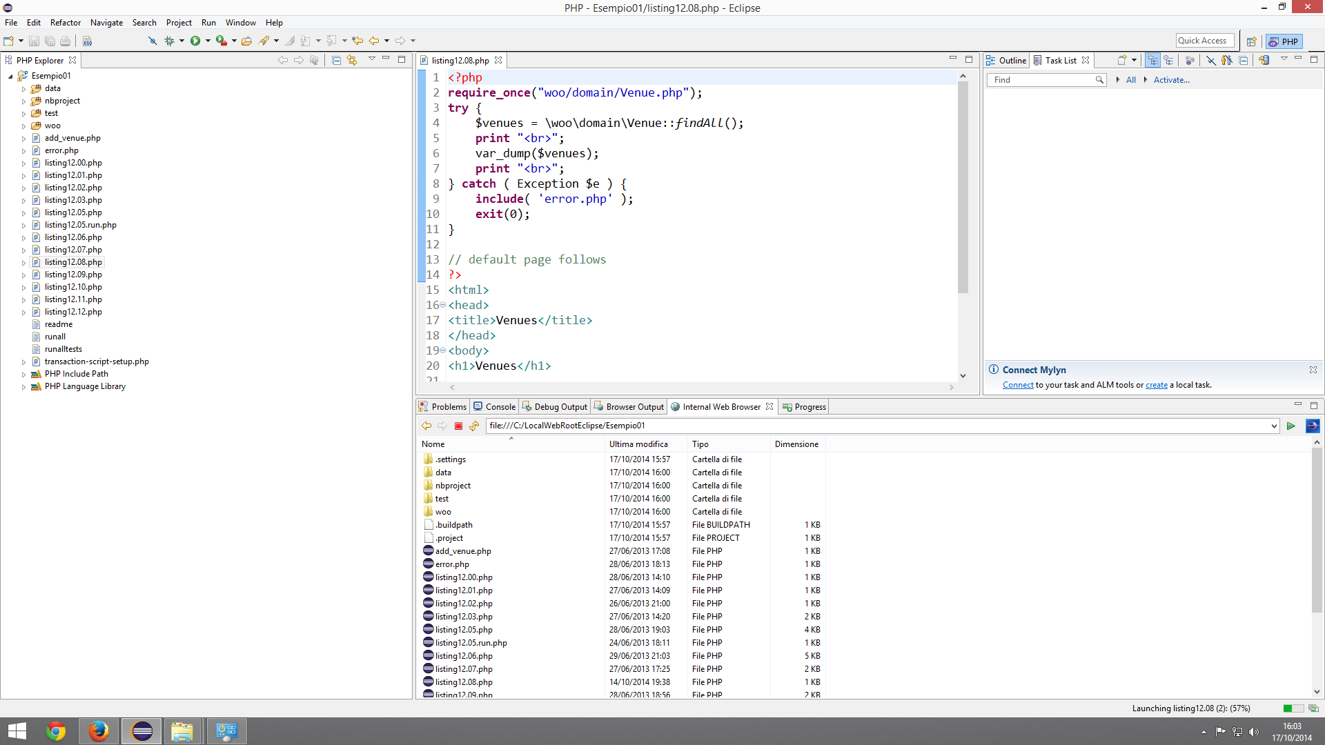

I am studing PHP and English togheter. I am sorry for my writing and reading. I hope to understand your helps. I use NetBeand from many week and recently I wrote on NetBeand forum to understand like debugging php file. A person sent to me many pages to read and I worked many days to understand like to see NetBeand working but without success. Last year I used Eclipse to study Java so now I would like to do a try with your software if you can help me too. With NetBeans I tried XDebug but my edits to php.ini was not good and that person could not help me more. In this time I have:
Windows 8.1
XAMPP (Installed today, last version)
Eclipse (Installed today, last version)
Could you help me to understand like I can to do that with Eclipse? Is it possible or is it very hard or impossible like on NetBeans?
I hope to pass to Ecplise very soon!
Gianni

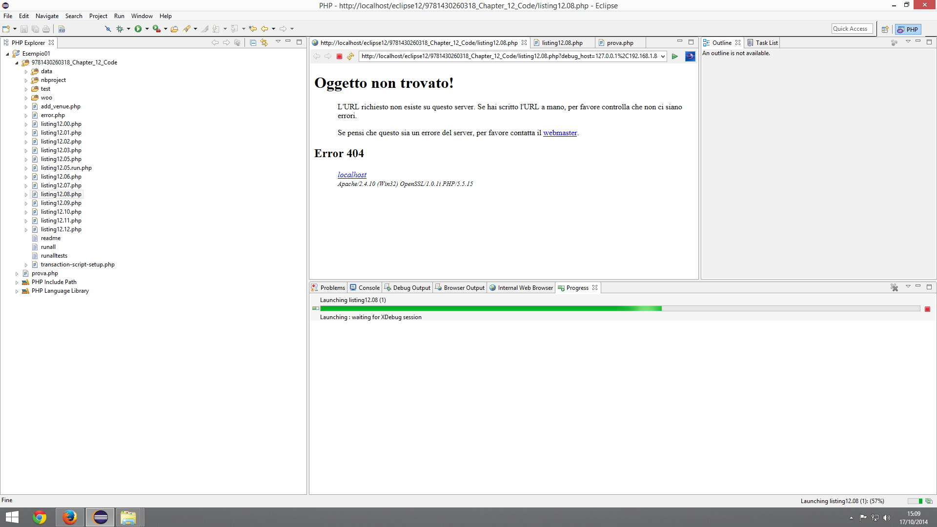

Thank you very much. I tried to do like I read in the brochure but I can not render the page.
  • Attachment: eclipse.png
    (Size: 143.34KB, Downloaded 203 times)
Re: Debugging a script with many files using the last version of Eclipse [message #1446899 is a reply to message #1446890] Fri, 17 October 2014 09:29 Go to previous messageGo to next message

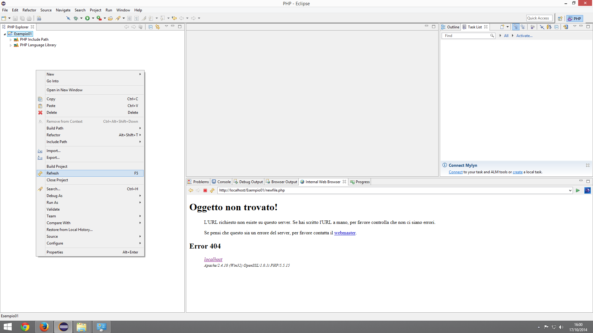

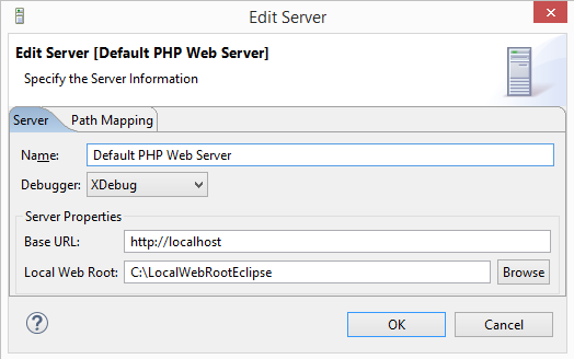

Are you sure that you configured eclipse correctly?
1. Copy url from internal browser (BTW: you can switch to external browser if you want), remove everything after "?" and try in any external browser. It work? Maybe you configured xamp on non standard (80) port, or you have your app in another subdir?
2. As I see in url you configured Zend Debugger, no XDebug
Re: Debugging a script with many files using the last version of Eclipse [message #1446921 is a reply to message #1446899] Fri, 17 October 2014 10:10 Go to previous messageGo to next message
Dawid Pakula wrote on Fri, 17 October 2014 13:29

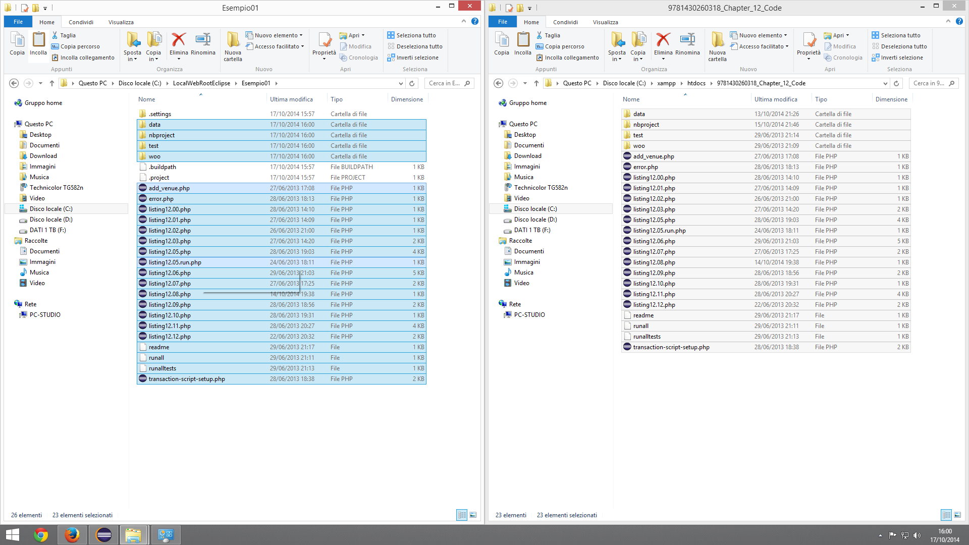

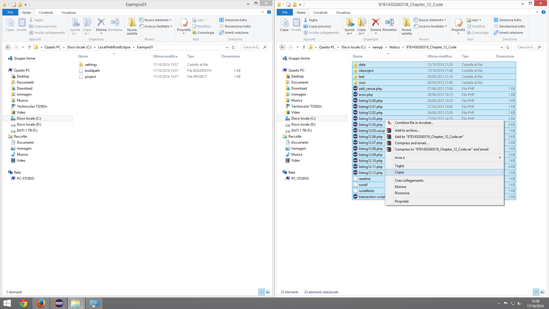

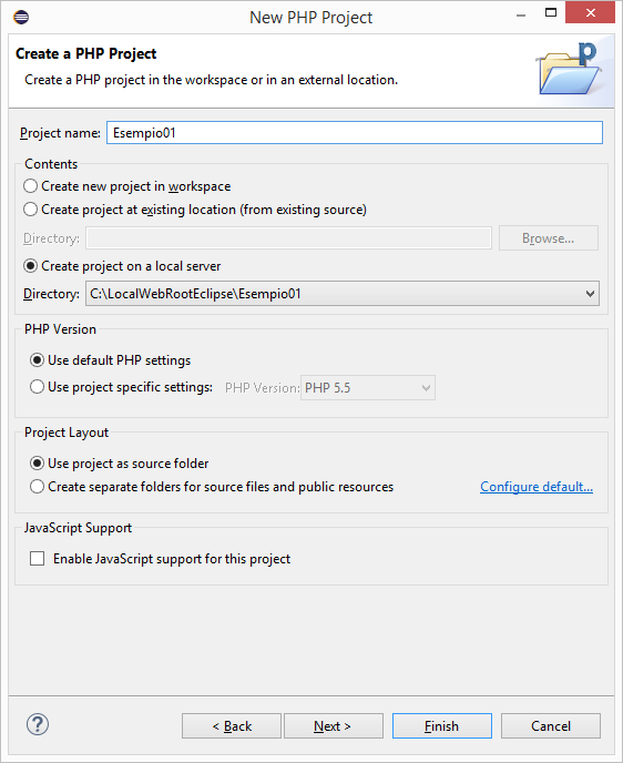

I read your documentation! I tried to create a directory into:
C:\xampp\htdocs\
but Eclipse has stopped me so I created a directory into C:.
1.If I write file:///C:/LocalWebRootEclipse/Esempio01/listing12.08.php into Mozilla the file doesn't work because I am not in localhost.
2.No I don't I setted XDebug I am sure.
Watch my pictures please.

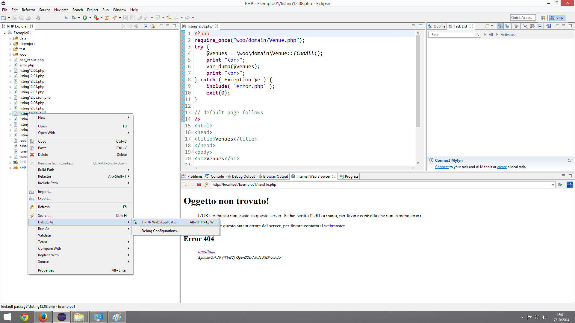

Re: Debugging a script with many files using the last version of Eclipse [message #1446924 is a reply to message #1446921] Fri, 17 October 2014 10:11 Go to previous messageGo to next message
No Message Body
  • Attachment: 06.png
    (Size: 176.49KB, Downloaded 224 times)
  • Attachment: 07.png
    (Size: 184.62KB, Downloaded 220 times)

Thank you very much! Smile
I tried to delete all directories and files of Eclipse e I read your brochure again. I seen finally XDebug to work but I don't like it for two reasons:
1) When I click on the green arrow the indicator doesn't move;
2) Internal web browser doesn't update itself during the running.
Gianni
