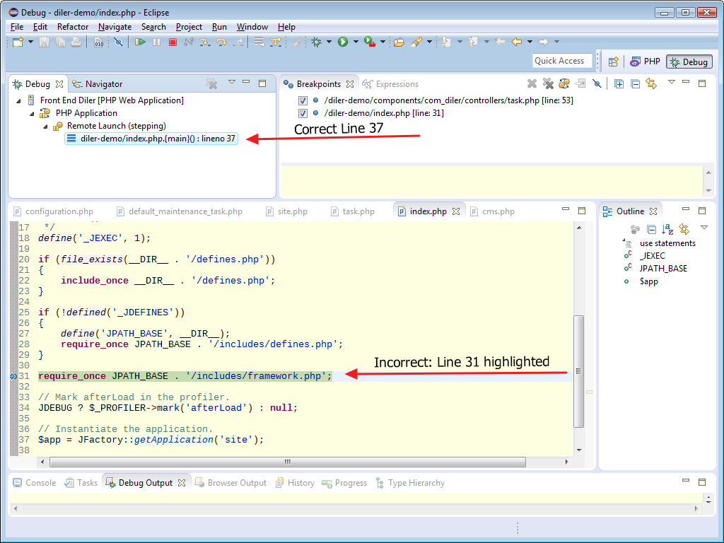

I've been using Eclipse PDT 4.4.0 with XDEBUG happily for several months. I just upgraded to 4.4.1 and now the step over in the debugger doesn't display correctly. The line number in the Debug view advances correctly, but the highlighted line in the edit area does not advance, so you can't easily see the line where you are paused.
See attached screenshot.

I rolled my installation back to 4.0.0 and it now works correctly.
This may or may not be related. I use the PHP debugger a lot and in 4.0.0 noticed a very minor annoyance. When you have been debugging, sometimes when you initially hit a breakpoint, the highlighted line of code in the edit window incorrectly shows your last breakpoint instead of the current breakpoint. However, this is corrected as soon as you click the step-over button. However, in 4.0.1, the problem is major because the highlighted line doesn't advance at all and always shows the breakpoint line.

Starting a debug session works, but the highlighted line does not advance, as noted in the op. I'm able to advance the line manually by clicking on the 'Lookup Source' option in the debug view context menu.
Netbeans and Eclipse 4.4.0 seem to work so the issue would appear to be caused by something introduced in the latest update.
