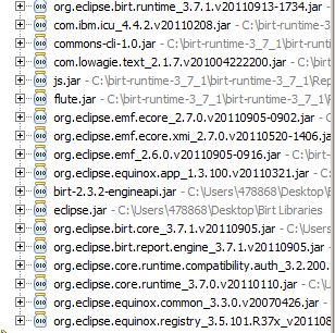

Please find attachment for libraries i'm using.

Do you have the birt runtime libs in your classpath/buildpath?
Remove this line:
config.setEngineHome(
"C:/birt-runtime-3_7_1/birt-runtime-3_7_1/ReportEngine" );
Jason
