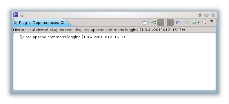

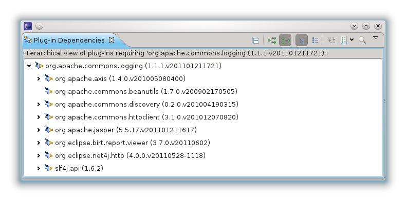

What's really puzzling is why the org.apache.commons.logging_1.0.4 get's materialized in the first place, as when I use the "Plug-in Dependencies" view in PDE it's not referenced at all, only org.apache.commons.logging_1.1.1 is:
index.php/fa/3835/0/
index.php/fa/3836/0/
Re: Buckminster does not materialize the source for all plugins [message #721085 is a reply to message #721008] Wed, 31 August 2011 16:35 Go to previous messageGo to next message

Edit 3: It would be interesting to know where the 1.1.1 version is coming from. To me it looks like the source repo (may it be p2 or maven), does not have proper source associated with it.
Like I said in a previous post, the 1.0.4 is the more mysterious one, as it's not referenced by other plugins.
I would not care that it's there if buckminster would also download the source for the 1.1.1, but it doesn't.

Is there a way to find out why buckminster picks the 1.0.4 logging when PDE shows that it's not referenced by any other bundle? Maybe that would give a clue to what's wrong here.
