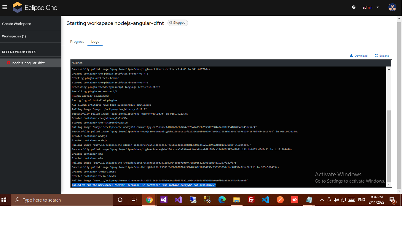

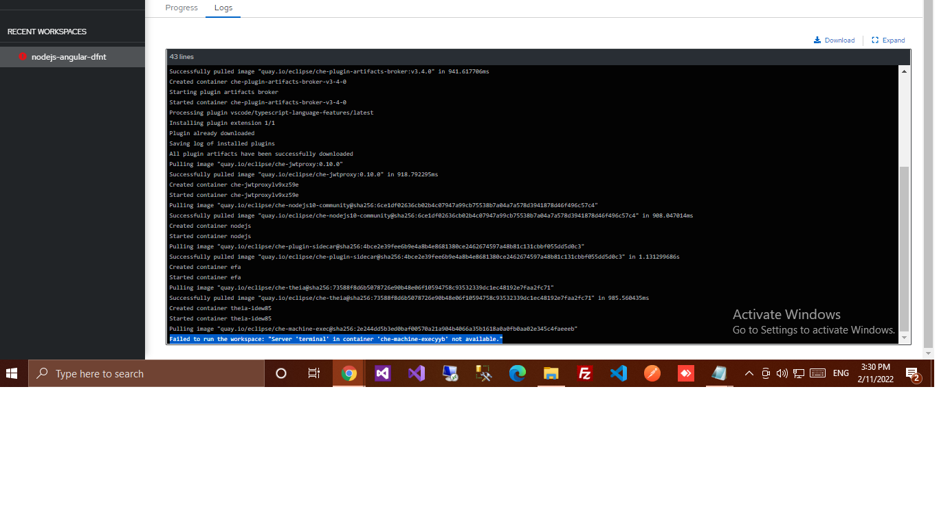

I have successfully installed the Eclipse Che 7.40.0 using chectl in AKS and resolved the blank Dashboard issue
Now, when I create a new workspace from the templates available inside Eclipse Che ( Code Ready workspcaes), getting the following error.
1.Failed to run the workspace: Server theia in container <theia container id created and started> not available.
(OR)
Failed to run the workspace: "Server 'terminal' in container 'che-machine-execyyb' not available."
Not in a position to resolve this.
Any help in this regard is appreciable.

Now, I'm able to login to Eclipse Che and trying to create workspace ( using the templates provided) and getting error and not able to view the IDE for any of the stack provided.
While starting the workspace, gives one of the following error: (Refer the screen grab attached in my earlier post)
(OR)
Can you help me or direct me to where I would get a resolution.
