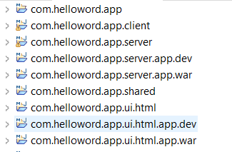

1 - Create a new helloworld scout project :
This project is going to be the core project, it contains the three outlines on the helloworld project.
index.php/fa/41286/0/

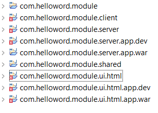

2 - Then create a second scout project named helloworld.module
index.php/fa/41287/0/
This second project is going to add a new outline to the first one
I replaced the Desktop and ClientSession with Extensions

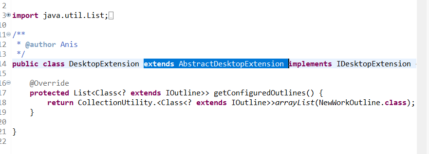

Code for Desktop Extension
index.php/fa/41289/0/
Please not here there is 2 IDesktopExtension
Witch one should be used :
org.eclipse.scout.rt.client.ui.desktop.IDesktopExtension;
org.eclipse.scout.rt.client.extension.ui.desktop.IDesktopExtension
Since it implements the Idesktopextension it should be loaded automatically in the core as it is a @Bean

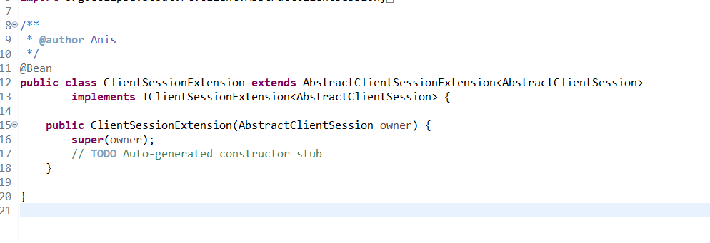

Same think fot ClientSession
index.php/fa/41290/0/

Regarding the extension interface: You probably want org.eclipse.scout.rt.client.ui.desktop.IDesktopExtension, since it is a @Bean. All other interfaces with ".extension." in the package name are the other kind of extension that has to be manually registered in the extension registry (as described above).
