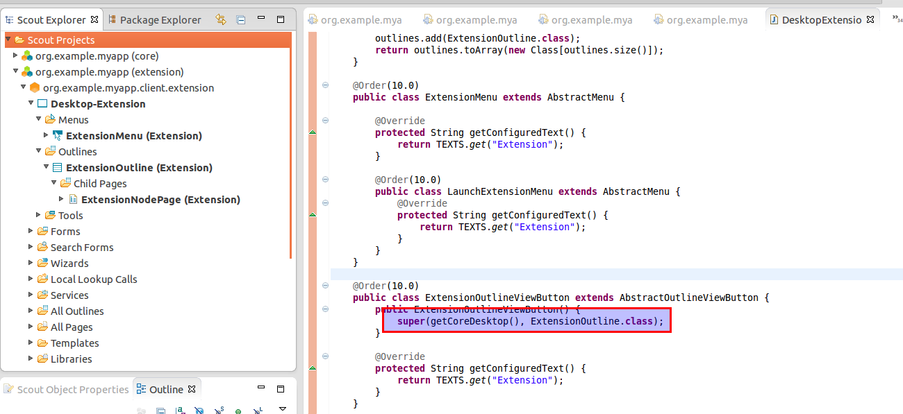

Re: Modular Application [message #1037682 is a reply to message #1034562] Tue, 09 April 2013 18:31 Go to previous messageGo to next message
If you follow the steps above and create the desktop extension class yourself (in step 5), the class can really look as simple as the following:
package org.example.myapp.client.extension.ui.desktop;
import org.eclipse.scout.rt.client.ui.desktop.AbstractDesktopExtension;
public class DesktopExtension extends AbstractDesktopExtension {
You then can add outlines and menus to the desktop extension from the Scout SDK. This is exactly what I did in my previous post, where I quickly click-and-built a desktop extension with a sample outline and menu.
The SDK generated the following code for me:
import java.util.ArrayList;
import org.eclipse.scout.commons.annotations.Order;
import org.eclipse.scout.rt.client.ui.action.menu.AbstractMenu;
import org.eclipse.scout.rt.client.ui.desktop.outline.AbstractOutlineViewButton;
import org.eclipse.scout.rt.client.ui.desktop.outline.IOutline;
import org.eclipse.scout.rt.shared.TEXTS;
import org.example.myapp.client.extension.ui.desktop.outlines.ExtensionOutline;
	@SuppressWarnings("unchecked")
	protected Class<? extends IOutline>[] getConfiguredOutlines() {
		ArrayList<Class<? extends IOutline>> outlines = new ArrayList<Class<? extends IOutline>>();
		outlines.add(ExtensionOutline.class);
		return outlines.toArray(new Class[outlines.size()]);
	@Order(10.0)
	public class ExtensionMenu extends AbstractMenu {
		protected String getConfiguredText() {
			return TEXTS.get("Extension");
		@Order(10.0)
		public class LaunchExtensionMenu extends AbstractMenu {
	@Order(10.0)
	public class ExtensionOutlineViewButton extends AbstractOutlineViewButton {
		public ExtensionOutlineViewButton() {
			super(getCoreDesktop(), ExtensionOutline.class);
Hope this helps.

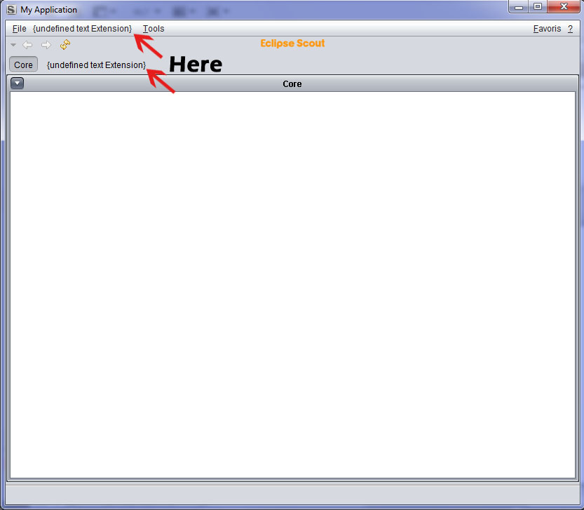

Re: Modular Application [message #1041105 is a reply to message #1037682] Sun, 14 April 2013 12:28 Go to previous messageGo to next message
Thanks Lukas for your help, it is very useful.
However, I still have a small problem.
I added a menu and an outline in the extension, but the associated text is not displayed correctly.
It shows me "Undefined text Extension" (see the picture below)
Thanks in Advance,
Yassine.

Re: Modular Application [message #1041478 is a reply to message #1041105] Mon, 15 April 2013 02:42 Go to previous messageGo to next message
This has nothing to do with Extensions... It just means that Scout Text provider is looking for a text that does not exist.
In the code provided by Lukas there is:
Just change "Extension" with the text key you want to have in the OutlineViewButton.
Let me know if you need more explanations.
