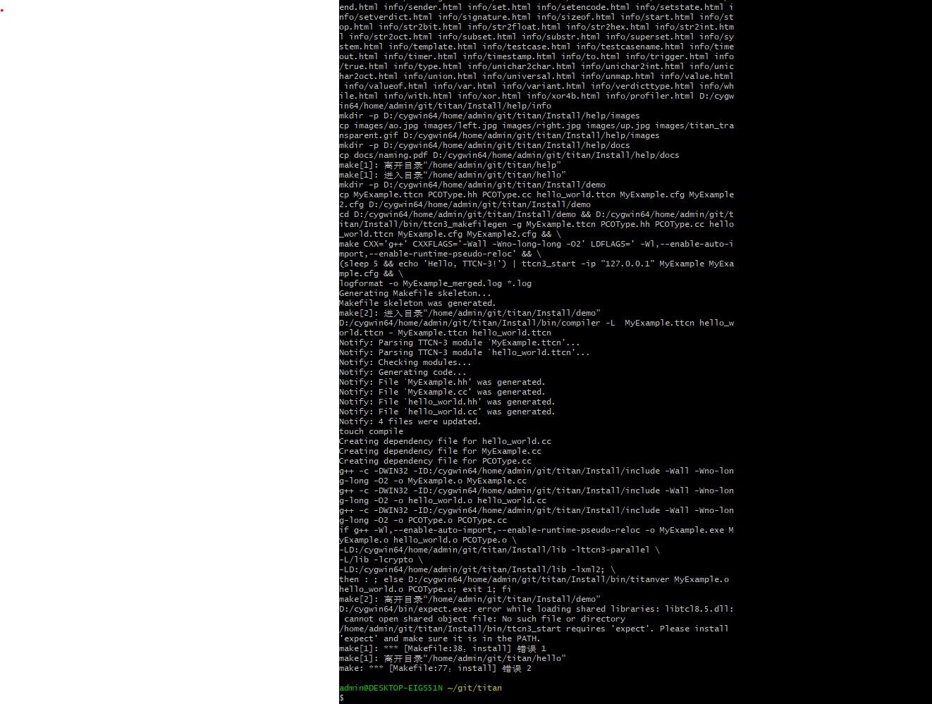

I install the TITAN on Win10.
The problem happens in compile TITAN.When I type in 'make -dep',there are some fatal errors. Then I type make install,there are errors .Error1 and Error 2.
Pls see the attachment.
Could someone help me ?

I choose the "tcl expect' when install cywin.But there are still errors in the step"make install"see the attachment below.
BR,
Didi

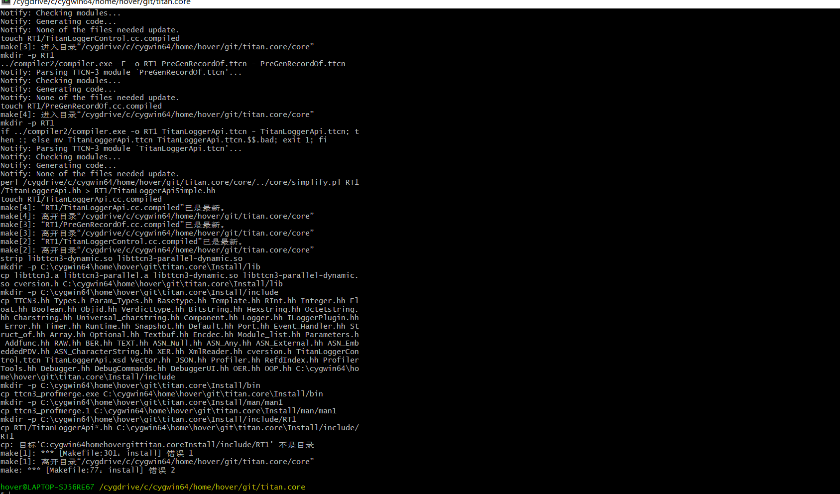

Could you please check the contents of your Install directory?
In particular the c:\cygwin64\home\hover\git\titan.core\Install\include\RT1 forlder.
I can not read the Chinese characters, but maybe the folder is read only, or looking at it might help us further in some way.
Also please note that when using cygwin one can copy out the texts too.
In my case I just need to select the text in the terminal window, right click on the toolbar of the terminal window and select edit/copy ... after this the text can be copy pasted.
(or at least it works with ascii characters on my machine)
