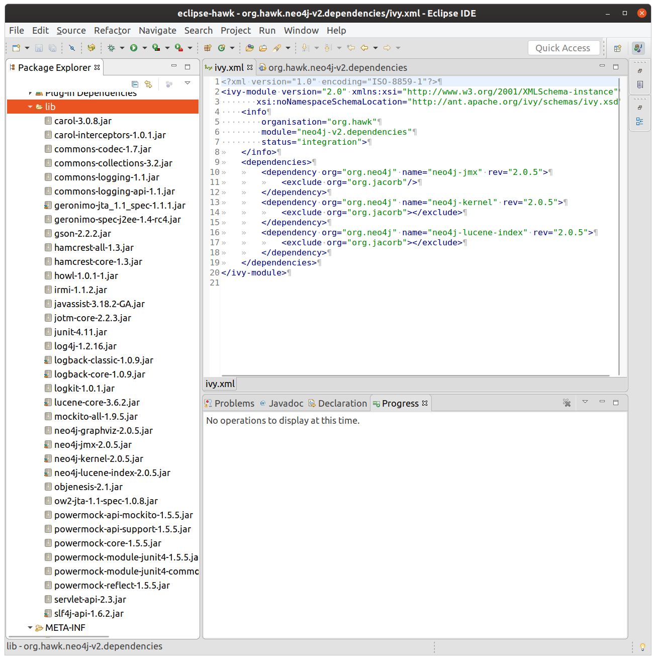

We had to change the ivy.xml file inside the neo4j-v2.dependencies plugin as the version at the time was picking up a version of org.jacorb which was no longer available. You should have this change already if you are on the tip of the master branch, though.
After that change, neo4j-v2.dependencies has resolved fine for me. I have tried just now to retrieve Ivy dependencies in neo4j-v2.dependencies from a clean Ivy cache, and I have not seen any issues.

Here is a screenshot of what the project looks like once you have resolved all dependencies from a clean Ivy cache, with Ivy 2.5.0 (the final version with the fix with the common issues).
index.php/fa/37340/0/
