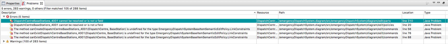

One last (hopefully) issue I can't get past is these errors I am getting about a link I've created that "can't be resolved or is not a field".
I don't quite understand why I'm getting these bugs with this link in particular, since its format is identical to all of my other links and they seem to be working fine.
I've attached a screenshot of the errors as well as my updated emf file.
If you get the chance to take a look, I'd appreciate it.
