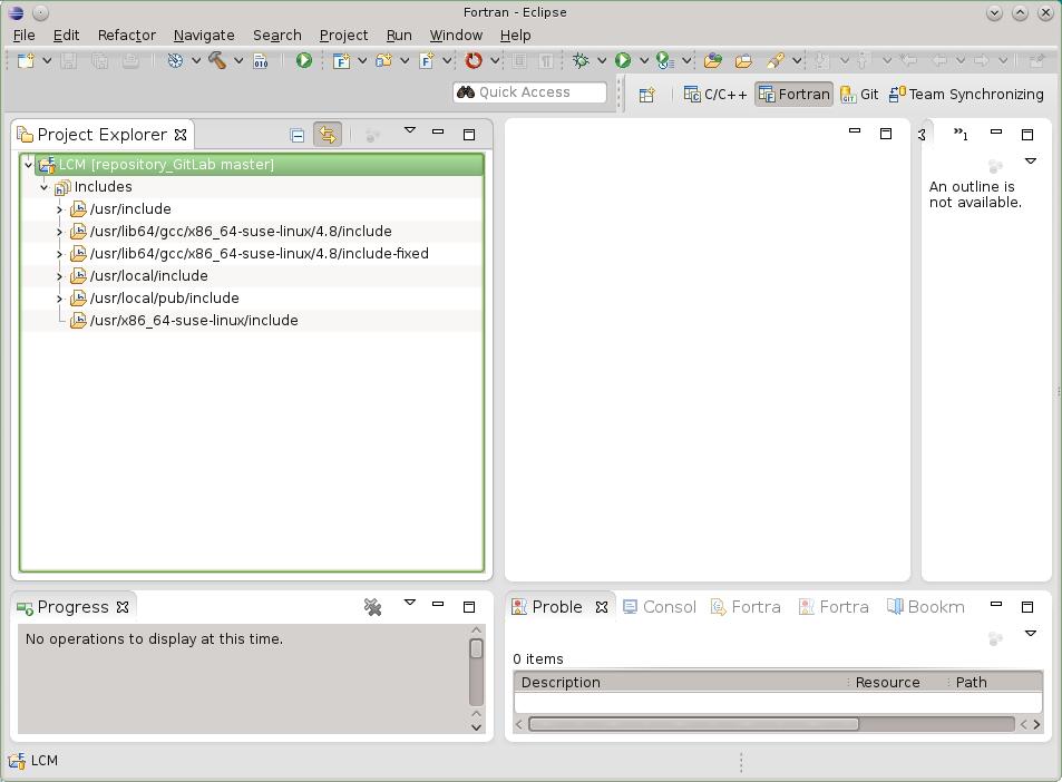

If I use the Git perspective, the repository and all its files are shown in the "Git Repositories Views". In this perspective the refactoring tools are not available.
When I switch to the Fortran perspective, the view "Project Explorer" contains the project B (it also indicates that it is linked to a repository). While the button "refactor" exists now, no source files are listed in this view. I tried "Customize View", but I cannot select *.F90 in this dialog box. It rather appears like the file extensions are related to C.
Related to this: Why are .h includes listed within this project? Project B is clearly a fortran project, not a C project!
