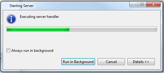

I`m trying to integrate RCPTT tests on Jenkins with rcptt-maven-plugin for continuous integration but I'm facing a problem in Jenkins, when maven executes our AUT that runs a CDO Server at the beginning and RCPTT doesn't wait for its complete initialization (when the modal dialog "Starting Server" disappears). Instead of that, RCPTT closes by default all dialogs at the beginning. Is there any option or configuration to override this behaviour? Can we wait for this dialog or for any dialog instead of closing them?

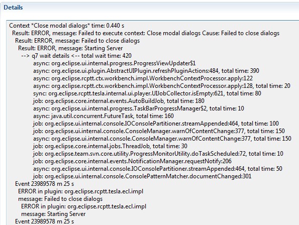

The tests run before the dialog close it. While the dialog is opened, those tests failed (RCPTT try to close the dialog).
I attached the dialog and the error.
