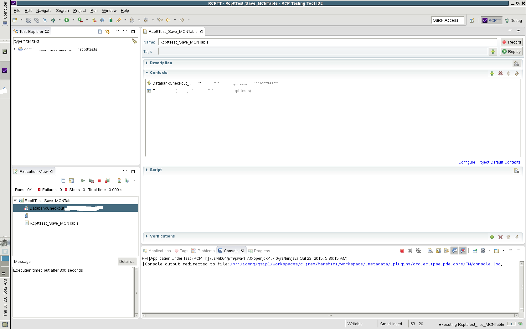

I have found that it hangs in very specific locations. For example: In the above given code, which is in an ECL Script Context, it doesn't enter the next context
I have attached the log files for the AUT in two different scenario. PFA.

Re: AUT is getting hanged up and gets timed out randomly [message #1702580 is a reply to message #1702573] Thu, 23 July 2015 07:53 Go to previous messageGo to next message
Thank you for additional details!
It will take some time to investigate it.
Is it correct, that ECL context fails by timeout when application hangs up?
Could you please wait until test execution is failed and send us Details from Execution view and HTML-report?
To get HTML report click "Report" in Execution view -> choose HTML format and set location-> Finish.

Re: AUT is getting hanged up and gets timed out randomly [message #1702594 is a reply to message #1702580] Thu, 23 July 2015 08:49 Go to previous messageGo to next message
The application (AUT) doesn't hang as far as I see it. But RCPTT is keep on trying to do something not going to next step. When it is keep on running, I tried to click menus and other widgets in my AUT and they are working fine. Which means there is no issue in AUT.
I have attached the files also console.log of rcptt in this. PFA.
