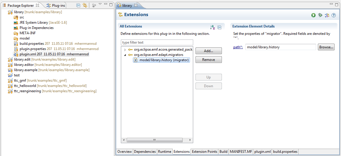

Re: Cannot create Migrator (Edapt/COPE) [message #865565 is a reply to message #715146] Mon, 30 April 2012 09:11 Go to previous messageGo to next message
I have created metamodel and a model.Now I want to change metamodel and check how it works on the model.I used a reuse operation 'rename' , executed the operation and released the history. Now I was stuck at registering the history to migrate the model. I went through the Edapt tutorial.
But I was not clear with the below statements.
To register the history, you need to use the extension point
"org.eclipse.emf.edapt.migrators" from the plugin
"org.eclipse.emf.edapt.history". Then you can use the migrator from the
second Eclipse instance like before.
Could someone please explain what I have to do in the eclipse editor with the above statements or provide me with some tutorial.
Lucky
Re: Cannot create Migrator (Edapt/COPE) [message #867379 is a reply to message #865565] Tue, 01 May 2012 05:00 Go to previous messageGo to next message
you have to open the plugin.xml Editor and go to the Extensions tab and
here you need to add an extension for extension point
org.eclipse.emf.edapt.migrators like shown in the attached image. If you
do not find the extension point, you have to add the plugin
org.eclipse.emf.edapt.history in the Dependencies tab.
If you have further questions, do not hesitate to ask.
