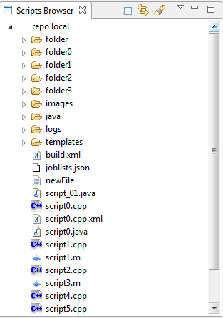

Re: JAVAGIT plugins isn't recognized [message #1622199 is a reply to message #1611288] Wed, 18 February 2015 05:30 Go to previous messageGo to next message
Yes, it's a RCP application.
I want to check the presence of value in this window and to realize drag and drop of a window to another window.
  • Attachment: JAVAGIT.png
    (Size: 15.30KB, Downloaded 137 times)
Re: JAVAGIT plugins isn't recognized [message #1622215 is a reply to message #1622199] Wed, 18 February 2015 05:44 Go to previous messageGo to next message
Thanks for the image. You should be able to map the tree component in the tabbed component and then use the "select" actions for tree on it to select items within it. You can also use the "check" actions for trees.
If I understand correctly, you want to drag the tabbed component (named Scripts Browser) to somewhere else - is that correct?
There aren't any tabbed -specific actions for drag and drop at the moment. You could try using the general drag and drop actions to drag the tabbed component (using the x and y positions to specify that you want to drag it from the title area) and then use the drop action on the component you want to drop onto. The drag and drop actions are documented in the reference manual, which is installed with the Jubula standalone and also available as online help.

Re: JAVAGIT plugins isn't recognized [message #1645112 is a reply to message #1622215] Mon, 02 March 2015 05:35 Go to previous messageGo to next message
Thank for you answer.
Yes indeed, my goals is to select an item and drag it to the other tree.
My only problem is I cannot map my tree "ScriptList" even manually with:
- Start Object Mapping.
- Select the component.
- CTRL + Shift + Q.
Re: JAVAGIT plugins isn't recognized [message #1645591 is a reply to message #1645112] Mon, 02 March 2015 10:41 Go to previous messageGo to next message
Hi Dorian,
Thanks for the information. You should see the green border around the whole tree when you are in the object mapping mode. If you can't, can you answer these questions:
- do you have other trees in the application that you can map?
- if so, you may need to check with the development team to see what the differences are.
Keep me posted!
Alex
