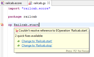

Hello again!
Another very similar problem came up to me. What I now have to do is this:
I want to reference an EOperation without the corresponding class in the model.
The document shall look like this:
import "railcab.ecore"
package railcab
op Railcab.start
and the grammar looks like this:
grammar org.xtext.example.mydsl.GetterSetter with org.eclipse.xtext.common.Terminals
generate getterSetter "http://www.xtext.org/example/mydsl/GetterSetter"
import "http://www.eclipse.org/emf/2002/Ecore"
Model:
	imports+=Import*
	('package' packages+=[EPackage])*
	operations+=Operation*;
FQN: ID ('.' ID)*;
Import returns Import:
	'import' importURI=STRING;
Operation:
	'op' op=[EOperation|FQN];
My ScopeProvider looks like this now:
var Function<EOperation, QualifiedName> getNameComputationForOperation = [
		QualifiedName::create(it.getOperationName)]
	def String getOperationName(EOperation feature) {
		return feature.EContainingClass.name + '.' + feature.name
	def IScope scope_Operation_op(Operation operation, EReference ref) {
		val scope = new ArrayList<EOperation>()
		val model = operation.eContainer as Model
		model.packages.forEach[p|
			p.EClassifiers.filter(typeof(EClass)).forEach[eclass|
				scope.addAll(eclass.EOperations)
		return Scopes::scopeFor(scope, getNameComputationForOperation, IScope.NULLSCOPE)
But this does not seem to work, because I get this error
index.php/fa/20861/0/
but the quickfix tells me that the object exists.
When I use any symbolc other than '.' it works just fine.
So what am I missing here?
Thanks in advance,
Florian
Re: Replacing an EStructuralFeature with a placeholder name in Xtext DSL [message #1618033 is a reply to message #1617842] Sun, 15 February 2015 12:44 Go to previous messageGo to next message
if the name consists of several junks you have to respect that.
Use iqualiednameconverter or qualifiedname.create(part1,...,partn)
Re: Replacing an EStructuralFeature with a placeholder name in Xtext DSL [message #1618101 is a reply to message #1618033] Sun, 15 February 2015 13:47 Go to previous message
Thanks again Christian! I thought my code would do exactly the same thing (because of the auto corrections), so I was digging in the wrong direction with my research.
QualifiedName.create("part1.part2") does not the same as QualifiedName.create("part1", "part2").
Well thanks again Smile
