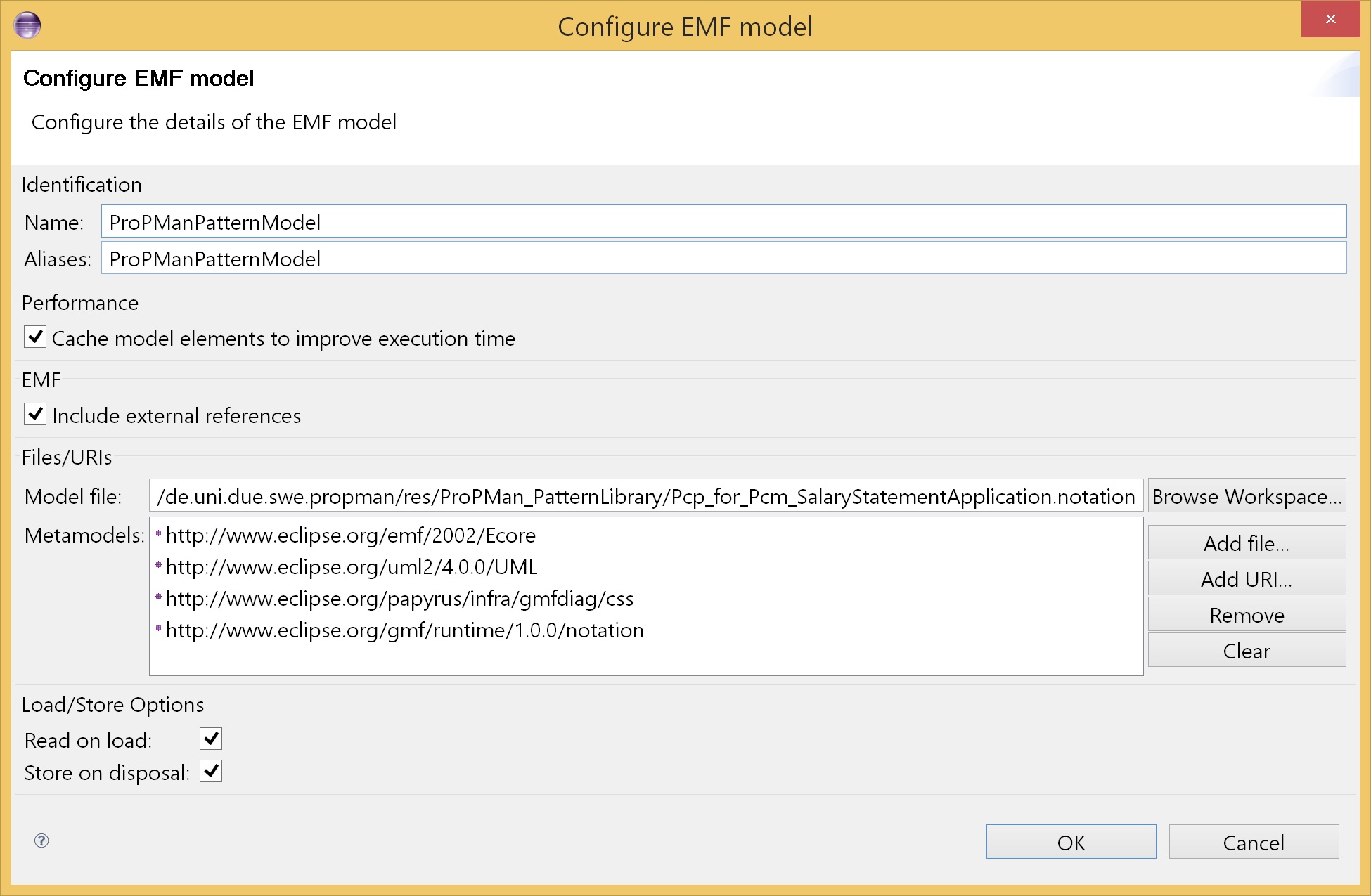

thanks for that hint. In the meantime, I have been able to find a way to create a Papyrus diagram using an EOL script. I attached a screenshot of the configuration settings as well as the EOL script itself to this answer. It works fine when I launch it separately. The problem that I am now struggling with is that I do not manage to execute this EOL script from my Java plug-in. I do not know how to create an appropriate model within my plug-in. I just tried to use the following you provided me some time ago that is valid for UML metamodels and works fine for that:

If I use an InMemoryEmfModel instance created according to the preceeding code for the Papyrus notation file, the EOL script returns errors that are related to the meta model (e.g. "Diagram" is not a valid variable, type or model").
I am not sure whether I do mistakes in adding the meta model properties. In the following code excerpt, you see how I use them. The excerpt shows the complete handling of my Papyrus diagram creation within my Java plug-in:
 * Testing area: Create Eol module to generate diagram of the target model:
		InMemoryEmfModel pcpTgtNotationModel = null;
		pcpTgtNotationModel = this.getUmlModel("PcpNotationModel",
				pcpTgtNotationFile);
		StringProperties tgtDiagramProps = null;
		tgtDiagramProps = new StringProperties();
		tgtDiagramProps.put(InMemoryEmfModel.PROPERTY_FILE_BASED_METAMODEL_URI,
			"http://www.eclipse.org/gmf/runtime/1.0.2/notation");
				"http://www.eclipse.org/emf/2002/Ecore");
				"http://www.eclipse.org/papyrus/infra/gmfdiag/css");
				"http://www.eclipse.org/uml2/4.0.0/UML");
		tgtDiagramProps.put(InMemoryEmfModel.PROPERTY_READONLOAD, true + "");
		tgtDiagramProps.put(InMemoryEmfModel.PROPERTY_STOREONDISPOSAL, true + "");
		pcpTgtNotationModel.load(tgtDiagramProps, null);
		EolModule eolModule = new EolModule();
		eolModule.parse(this.getFileInBundle("/res/ProPMan_EpsilonModules/ProPGenEpsilonModules/GeneralPurposesEpsilonModules/PatternDiagramGenerator.eol"));
			if (eolModule.getParseProblems().size() > 0) {
				System.err.println("Parse errors occured...");
				for (ParseProblem problem :
					eolModule.getParseProblems()) {
					System.err.println(problem.toString());
				System.exit(-1);
		eolModule.getContext().getModelRepository().
			addModel(pcpTgtNotationModel);
		eolModule.execute();
		((IModel) eolModule).dispose();
It would be great if you can tell me how to properly create a model instance in Java that is based on the Papyrus notation file and the meta models given.
Thanks a lot in advance for your appreciated support and kind regards, Alex
