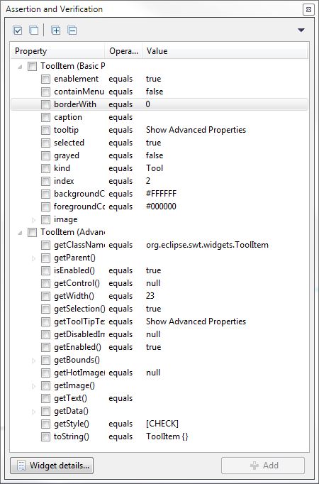

Could you please attach Widget Details of that button? Press button "Widget details..." in Assertion dialog and attach content of appeared window.
As I anderstand property "selected" is exactly what you need.
get-property selected | equals true | verify-true
On attached screenshot this property is "true".
Please let me know if it is suitable for you or you have any questions.

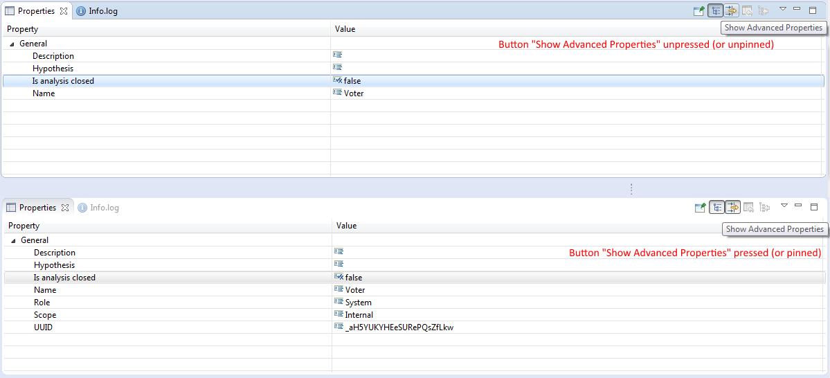

I try to determinate with RCP TT the status of the "Show Advanced Properties" button.
Is it pressed or unpressed (pinned or unpinned) ? See the attached picture for more explanation.

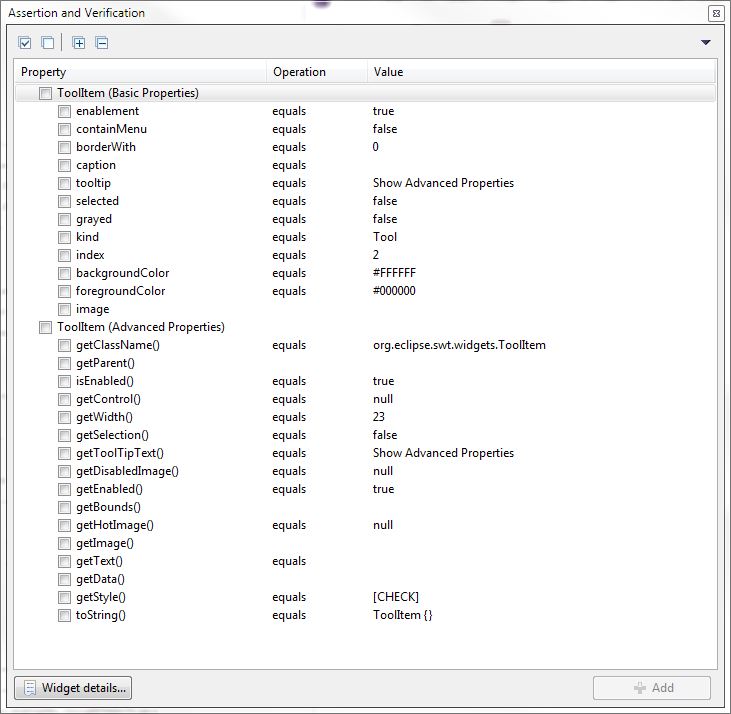

Please find in attachment, the details of the available properties in the "Assertion and Verification" window of the Show Advanced Properties button.

I tried the same button on my side and property "selected" turned out to be what you need.
