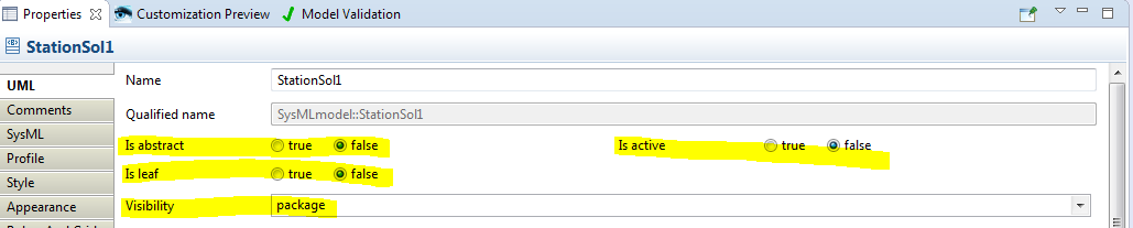

Re: Tool settings: How to cutomise Properties View [message #1592964 is a reply to message #1591376] Fri, 30 January 2015 05:33 Go to previous messageGo to next message
Thanks for these explanations. Customisation of the properties view is not easy to use and to obtain simplified and customised tabs.
Maybe I should reformulate my needs:
From the UML tab of the property view, is it possible to just hide the Is abstract, Is active, Is leaf and the Visibility ?
As I don't see the interest of them, I can imagine to have them hidden for a simple user.
Or the other case, what are Is abstract, Is active, Is leaf and the Visibility used for ?
Thank you
  • Attachment: Capture.PNG
    (Size: 16.79KB, Downloaded 180 times)
[Updated on: Fri, 30 January 2015 05:39] by Moderator
Re: Tool settings: How to cutomise Properties View [message #1593244 is a reply to message #1592964] Fri, 30 January 2015 09:00 Go to previous message
Hi Philip,
isAbstract = true indicates that the class is abstract, i.e., it can not have instances.
isActive =true indicates that the class is active, i.e., an object of that class commences its execution when it is instantiated ("has its own thread of control"). How that object reacts to stimuli is typically described by an "onwedBehaviour" (activity or state machine). If isActive=false, an object of that class needs to exist in the context of another object and its behavior are operations that are called by its container.
isLeaf=true indicates that the class can not have any more redefinition, i.e., it can not be sub-classed.
Visibility is used to constrain accessability of elements to a namespace. For example, a visibility of "package" indicates that a class can only be used by elements in its container package. This is useful, for example, for traceability to check for access violations.
