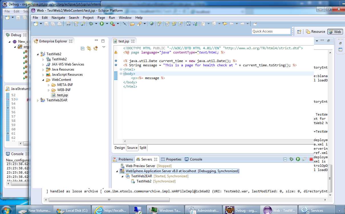

Re: Breakpoint on JSP does not work in Kepler [message #1589740 is a reply to message #1588015] Wed, 28 January 2015 11:30 Go to previous messageGo to next message
HI Larry,
Following is the jsp page that I use to test the jsp debug breakpoint :
I toggle breakpoint on line 3, 4, 5 and 6 and breakpoint tab shows these 4 breakpoints
defined.
But it does not stop on any lines during the jsp page is executed.
I heard that my colleague that jsp breakpoint works on their tomcat and eclipse.
1 <%@ page language="java" contentType="text/html; %>
2
3<%@ taglib uri="/WEB-INF/struts-html.tld" prefix="html" %>
4<%@ taglib uri="/WEB-INF/struts-bean.tld" prefix="bean" %>
5<% java.util.Date current_time = new java.util.Date(); %>
6<% String message = "This is test page for health check at " + current_time.toString(); %>
7<html>
8<body>
9 <p><%= message %>
10</body>
11</html>
Really frustrated now.
Do you have any sharing on this.
Ray

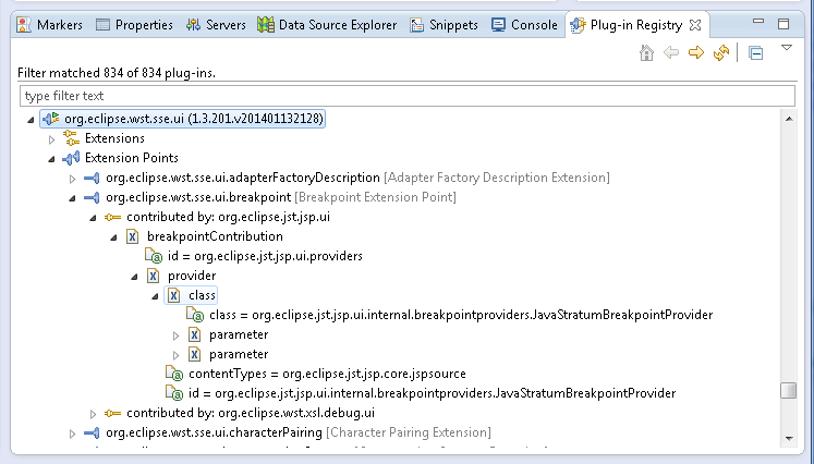

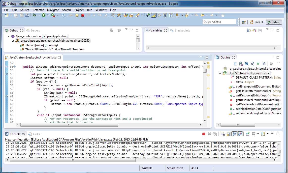

Re: Breakpoint on JSP does not work in Kepler [message #1602658 is a reply to message #1602534] Thu, 05 February 2015 13:17 Go to previous messageGo to next message
Raymond,
It's a few clicks, but fortunately setting this up is pretty straight
forward. You will need to install some Eclipse source which you can do
in your current Eclipse environment with no real impact, or you can set
set up a separate Eclipse environment that can duplicate the problem and
debug just with that environment. The advantage of setting up a
separate environment is that you will be able continue using your
current environment while separately debugging this problem. Once you
have made your choice, here are the steps to get that environment to the
point where we can diagnose this:
1. Install needed source...
1.a Execute Help -> "Install New Software..." and select "The Eclipse
Web Tools Platform (WTP) software repository" as the "Work with" site.
1.b Expand "Web Tools Platform SDK (WTP SDK) 3.5.2" in the list, scroll
down, and select "Eclipse Java Web Developer Resources for Plug-in
Developers".
1.c Complete the installation of the "Eclipse Java Web Developer

Step 3.b assumes you have Eclipse #2 running and in that Eclipse you
could import your test project and any server setup needed, then see if
you can duplicate the problem.
Once you can duplicate the problem, in Eclipse #1 open the
"org.eclipse.jst.jsp.ui.internal.breakpointproviders.JavaStratumBreakpointProvider"
class file source. If you haven't enabled line number display,
right-click in the "JavaStratumBreakpointProvider.java" editor window
and select "Preferences...". Expand General -> Editors -> "Text
Editors" and enable "Show line numbers" and click OK. Set breakpoints
at lines 55, 61, 79, 86, and 89. Then in Eclipse #2, enable a
breakpoint in your JSP. In Eclipse #1, the breakpoint at line 55 should
be hit. Click Resume to continue and see what other breakpoints are hit.
For me using Tomcat I hit 55, 61, then 89.
Let me know how it turns out or if you have questions.
Cheers,
Larry

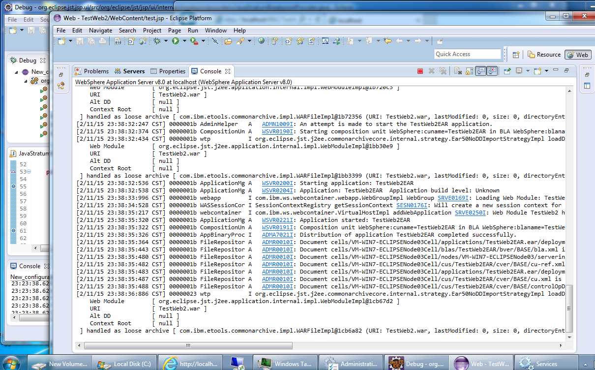

Hi Larry,
I have followed your steps and debug a test.jsp page, but strange that no debug stop on line 55 within JavaStratumBreakpointProvider.java when I run test.jsp page on IE browser,
no any breakpoint hit from 55, 61, 79, 86, and 89. It looks that the system flow does not go into this class.
URL I try to access the page : http://localhost:9082/TestWeb2/test.jsp
I upload some screens for your reference and do you think I miss any important steps to make eclipse to enable debug jsp mode?
Ray

To register a breakpoint, some "provider", like
JavaStratumBreakpointProvider, will need to be called to perform the
breakpoint registration. You have established that
JavaStratumBreakpointProvider isn't being called when you enable a
breakpoint in the JSP in your editor. At this point, we don't know
whether some other "provider" is being called, or no provider is being
called. Certainly, the later would explain the behavior you are seeing.
The JVM is not going to stop at a breakpoint that never gets registered.
I do notice that the icon in the tab of your editor and in the
"Enterprise Explorer" tree is different from what I see in my JavaEE
Eclipse and doesn't appear to match any editor I have installed. What
choices do you get in the upper section when you right-click on test.jsp
and select "Open With". I get "JSP Editor", "Text Editor", and "Web
Page Editor". I am able to hit the breakpoints in
JavaStratumBreakpointProvider enabling breakpoints in the "JSP Editor"
and "Web Page Editor". What happens if you open the file with either of
these and try to enable breakpoints?

Something worth checking is the Plug-in Registry to see what is
configured as breakpoint providers.
1. In Eclipse #1, Execute Window -> Show View -> Other...
2. Expand "Plug-in Development" and select "Plug-in Registry" and click OK.
3. Scroll down in the list to find the "org.eclipse.wst.sse.ui" item and
expand it like that shown in the attachment.
Do you see this "breakpointContribution" in your registry? Do you see
additional "contributed by:" entries under the
"org.eclipse.wst.sse.ui.breakpoint" Extension Point beyond those shown
in the attachment.
Cheers,
Larry

I doubt there would be any effort to fix this issue for Kepler at this
point. It would be useful for you to verify if you see this same issue
with Luna. If you do see the issue, then check the Plug-in Registry
like I mentioned a few posts back. That would be the first place to
look for what is different between the Marketplace install and the
archive install.
