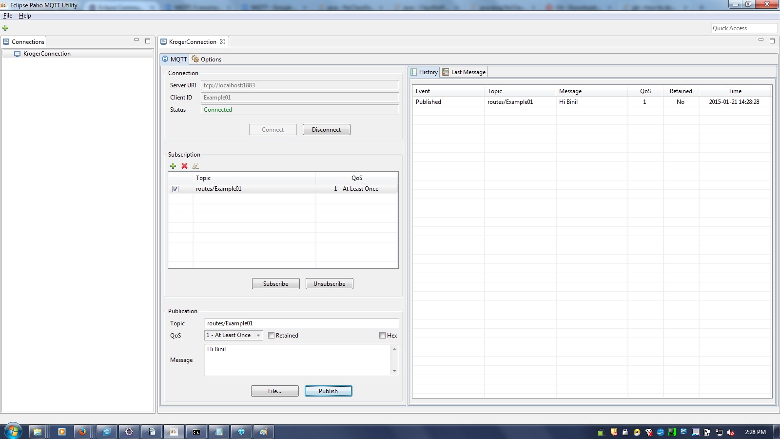

I am new to MQTT and I am using Eclipse Paho MQTT Utility for testing purpose. I installed mosquitto broker with port 1883 and when I tested using paho eclipse both publish and subscribe is working fine.

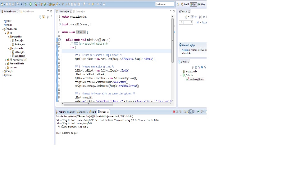

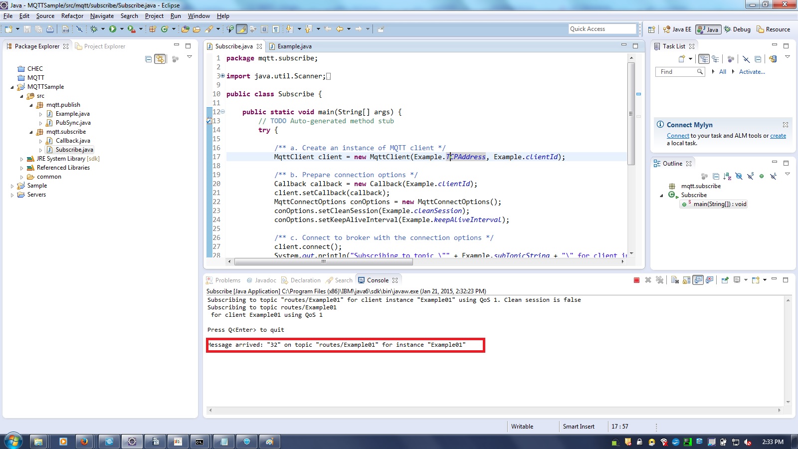

I am developing a subscription code(Subscriber.java) and when I individually tested the subscriber code with mosquitto_pub -t routes/Example01 -m 32 -q 1 it is working fine.
But my intention to run the publisher part using paho mqtt utility and it is not subscribing.
Could you please help me on this and attached the screen shot which i am referring.
Also I would like to consume the xml file instead of string and can you please suggest is it possible via paho client utiliy with Subscriber code.

Hi ,
The client id should be different for the publisher and subscriber for running the paho utility and now once I changed it is working fine for me.
Binil
