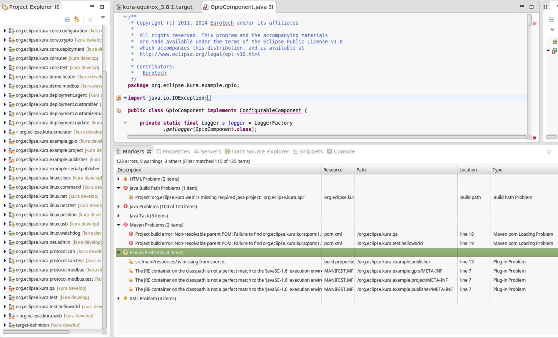

I am also having problems building in eclipse. Followed all steps in getting started and built the source with-out errors. But It will not build in eclipse.
I have attached a screenshot and a text file with the details. Any suggestions?

Summary:
- gpio build, publisher, project, qa, hello world, and web builds fail.
- Java build path problem for web.
- Maven non-resolvable parent POM.
index.php/fa/21206/0/
Thanks!
-Jeff

Hallo Jeff,
The "Non-Resolvable" parent pom error is due to the wrong version number in the pom.xml file.
Change the version tag in org.eclipse.kura.qa/pom.xm and org.eclipse.kura.test.helloworld/pom.xml
	<parent>
		<groupId>org.eclipse.kura</groupId>
		<artifactId>kura</artifactId>
		<version>1.2.0-SNAPSHOT</version>
		<relativePath>../manifest_pom.xml</relativePath>
	</parent>
Jishnu
