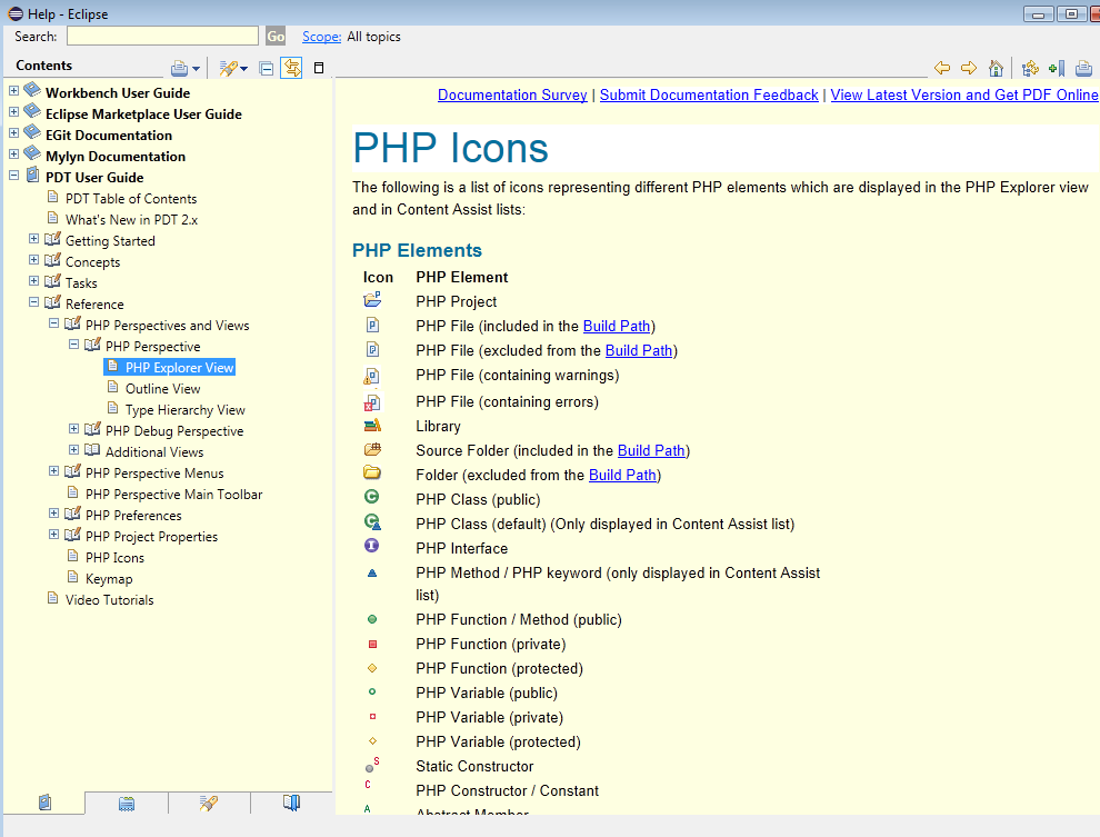

I created a new PHP project (from existing source), and some of the folders look normal but some have what looks like a plus sign on them. Upon closer inspection it looks like a yellow box with a cross through it coming out of the folder.

It means the folder is included in the PHP build path. See the screenshot attached.
  • Attachment: Image1.png
    (Size: 75.00KB, Downloaded 232 times)

Current PDT documentation is available under: https://www.eclipse.org/pdt/help/html/toc.htm
See also: https://www.eclipse.org/pdt/help/html/php_icons.htm
It's a little bit outdated, we are working to fix this issue in Luna SR2.
By default build patch is created on project root dir. If you are using composer plugin, your build patch will be modified based on composer.json
