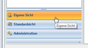

On the Scout Forum, someone is asking how he can catch the SWT accordions buttons with the Object Mapping Mode tool form Jubula.
index.php/fa/20331/0/
Is this possible?

Some details about the widget in the screenshot: it is using Nebula collapsiblebuttons
Is Jubula capable of detecting those widgets?
Re: Detect an SWT-Accordion Button with Jubula [message #1553075 is a reply to message #1549539] Thu, 08 January 2015 08:37 Go to previous message
Thanks for the additional information Jeremie. I've chatted with the guys here and it should be fairly easy to write an extension for either the individual buttons (easier) or to address the component as a more complex unity (such as a tabbed component, allowing each button to be clicked via its title or index -slightly less easy). The extension manual that is installed with the standalone version and also downloadable from the testing portal [1] provides information on how to write an extension. For assistance with any problems, feel free to write to the rc-dev-list. There's always the option to have the team write an extension for specific components as well - just contact us via the testing portal to start the conversation. At the moment, we don't have support for the nebula widgets in the standalone, though we have written extensions for other users for their specific cases.
