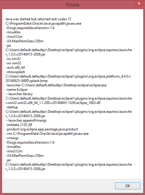

Hello! I am recently new to coding and such. I got a new desktop a few days ago and downloaded eclipse to begin coding again. However when I try to launch it, I get the Java Exit Code 13 error. I've tried re-installing Java many times but to no success. Below can be found the entire error. Thanks in advance for the help!
index.php/fa/20317/0/

Check the sticky post ( https://www.eclipse.org/forums/index.php/t/198527/ ) and then double-check that you have executable permission on all the *.exe and *.dll files.

what I think is the problem is the version of Java you're using, because I have a version that isn't compatible with the version of Eclipse.

Exit code 13 shows that you have changed the java version. The change can be a switch from 64 to 32 bit java or vice versa!!
I had this problem after changing my JAVA_HOME entry in Windows OS.

In my case it was a wrong java version. Check your java version (32 or 64 bit) that should be correspond to your version of eclipse.
A change of the path in JAVA_HOME to the correct java version helped in my case.

I was having the same problem but I was able to solve it. I have a 64 bits Windows 8.1 OS but all my browsers are 32 bits and I installed a 64 bits java. If you have same, you would have that same problem but what I did was to install both 32 bits and 64 bits java as the java has to be consistent with the browser (as in 32 bits in my case). I installed a 64 bit java because I might change my browser to 64 bits in the future and don't want to be faced with the problem again.
I hope this helps someone.
