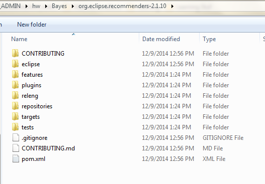

Re: Downloading/Installing Code Recommenders without Eclipse Marketplace [message #1506432 is a reply to message #1506370] Wed, 10 December 2014 16:23 Go to previous message
This is the folder i am choosing. I downloaded the zip and extracted it. Is it the right folder or do i need a different one?
