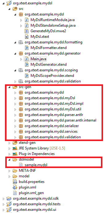

  • Attachment: 1.png
    (Size: 26.81KB, Downloaded 159 times)
Re: Using Xtext and Code Generator without Runtime [message #1479409 is a reply to message #1479408] Wed, 19 November 2014 07:04 Go to previous messageGo to next message
I have send a picture that shows my new mydsl project.
What is src-gen ?
My model is in dslmodel folder.
