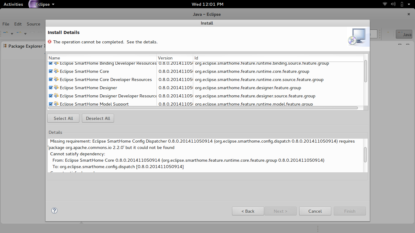

I am trying to install SmartHome in eclipse via install new software, but, unfortunately an error occurred saying "SmartHome Config Dispatcher requires org.apache.commons.io 2.2.0 which is not found.
any idea about that?!

Eclipse SmartHome has no Eclipse IDE plugins, it instead is a framework for headless runtimes.
To set up an IDE for development, please see https://github.com/eclipse/smarthome/blob/master/docs/sources/development/ide.md.
Alternatively, if you are looking for a full solution and not just a framework, you might want to have a look at openHAB 2 (see https://github.com/openhab/openhab2/blob/master/README.md)
