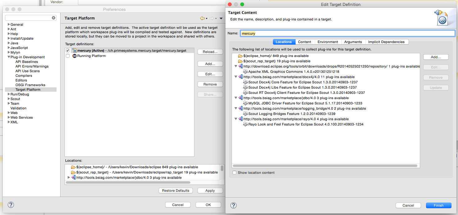

Hopefuly I've added the right screenshot - were not sure where to find the mentioned "Target Platform" preference page.
index.php/fa/19625/0/
https://www.eclipse.org/forums/index.php/fa/19625/0/
Still trying to understand your posted link and get things running.
really appreciate your help

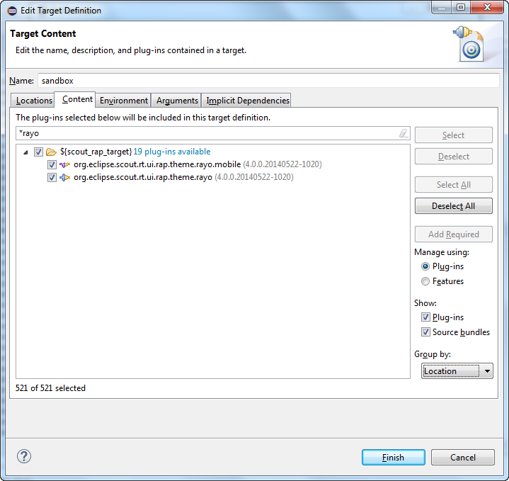

Yes this is the screenshot I was expecting.
If you change to the "content" tab, can you check if the plugin "org.eclipse.scout.rt.ui.rap.theme.rayo" you want to add to in the product is the list or not. You can use the filter.
If you select Group By "Location" (combo box on the bottom right) you will see the location of your target platform that is providing the plugin.
Here is how it looks like in my workspace:
index.php/fa/19631/0/
Of course it is possible to add a software location that is providing the requested plugin.
