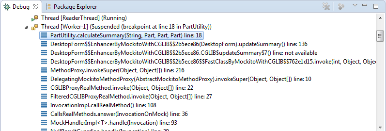

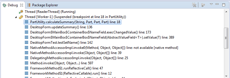

When I put a break point in PartUtility.calculateSummary(..) I see the 2 calls:
First call:
index.php/fa/19565/0/
Second call:
index.php/fa/19566/0/
In the second call, the DesktopForm is not instrumented by Mockito. This is why the spy do not think that updateSummary() was called twice.
