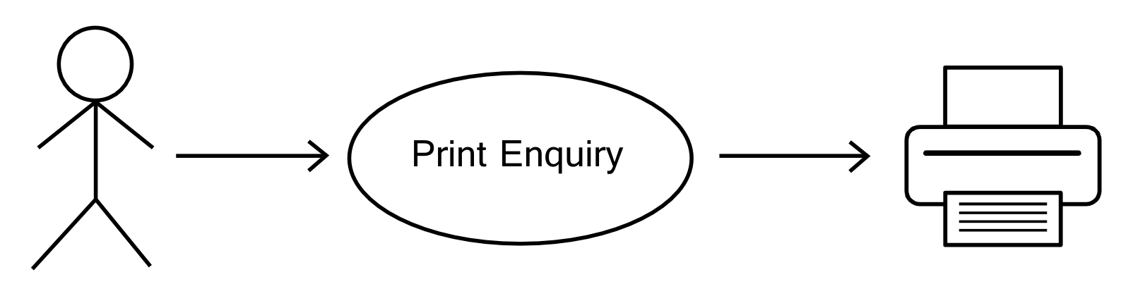

Hello all!
Is it possible to replace the default "actor" symbol by a custom image, e.g. a printer symbol?
Something like this:
https://www.eclipse.org/forums/index.php/fa/19528/0/
Thanks in advance!
  • Attachment: umltest.png
    (Size: 40.96KB, Downloaded 2053 times)
