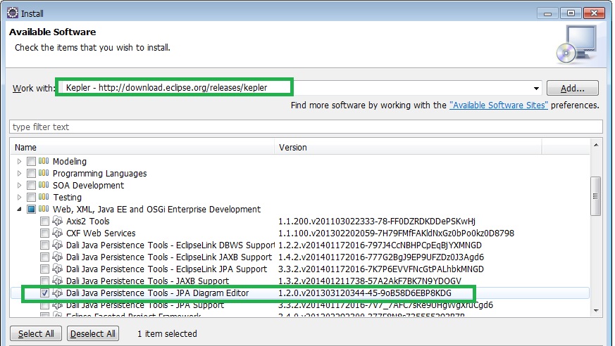

Hi Andrew,
I had the same problem after installing the JPA Diagram Editor via Eclipse Marketplace into Eclipse Kepler.
For some reason Eclipse Marketplace delivers an old feature-version org.eclipse.jpt.jpadiagrameditor.feature_1.1.2.v201301082148-408c9oB58C5FCB77B5. This feature contains the plugin org.eclipse.jpt.jpadiagrameditor.ui_1.0.3.v201301300050 which is binary incompatible to the Kepler plugin org.eclipse.jpt.jpa.ui_3.3.2.v201401172016.jar. That's why the Excpetion is thrown.
I resolved the problem after updating the JPA Diagram Editor Feature to Version 1.2 via the Eclipse Kepler update site.
index.php/fa/20761/0/
