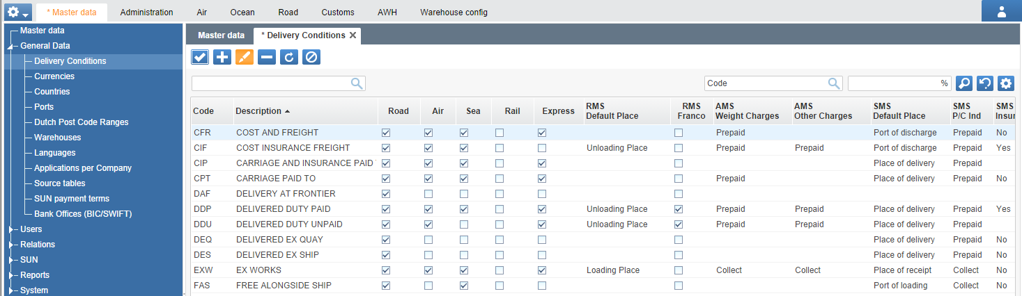

I am a newbie in Scout development, and currently figuring out the styling possibilities for a Scout RAP application (see the screeenshot to get an idea where i am going..).
I am trying to style the 'Save' button in RAP. I want to give it another backgroundcolor.
I know how to style buttons in the CSS, but is there a possibility to style a specific button backgroundcolor?
We have a toolbar with a save button like
public class SaveButton extends AbstractSaveButton {}
Is there a way in the CSS to style this SaveButton?
