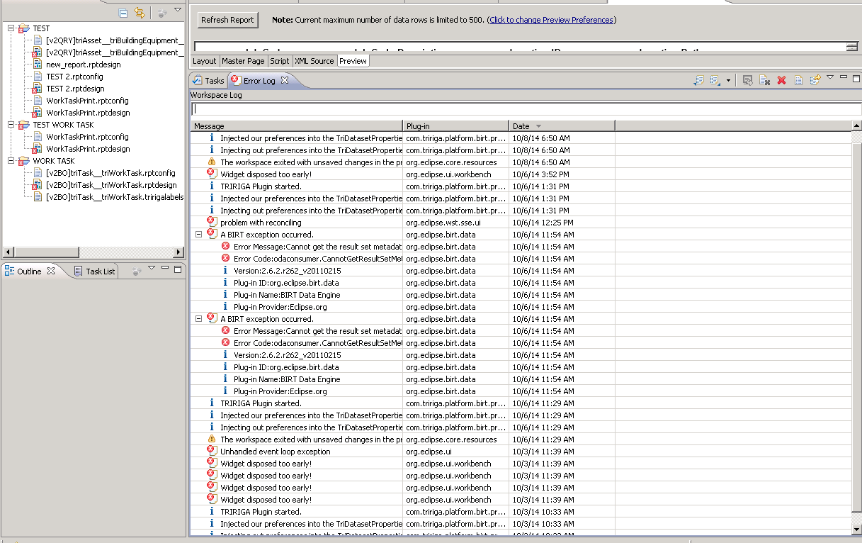

Re: Error .metadata\.log. when opening Eclipse [message #1440492 is a reply to message #1440485] Wed, 08 October 2014 08:40 Go to previous messageGo to next message
the Error log within Eclipse gives this:
!SESSION 2014-10-03 10:33:28.115 -----------------------------------------------
eclipse.buildId=M20110210-1200
java.version=1.6.0_45
java.vendor=Sun Microsystems Inc.
Command-line arguments: -os win32 -ws win32 -arch x86
!ENTRY com.tririga.platform.birt.preferences 1 0 2014-10-03 10:33:44.277
!MESSAGE Injecting out preferences into the TriDatasetProperties...
!ENTRY com.tririga.platform.birt.preferences 1 0 2014-10-03 10:33:44.293
!MESSAGE Injected our preferences into the TriDatasetProperties.
!MESSAGE TRIRIGA Plugin started.
!ENTRY org.eclipse.ui.workbench 4 0 2014-10-03 11:39:26.779
!MESSAGE Widget disposed too early!
!STACK 0
java.lang.RuntimeException: Widget disposed too early!
at org.eclipse.ui.internal.WorkbenchPartReference$1.widgetDisposed(WorkbenchPartReference.java:172)
at org.eclipse.swt.widgets.TypedListener.handleEvent(TypedListener.java:123)
at org.eclipse.swt.widgets.Widget.sendEvent(Widget.java:1053)
at org.eclipse.swt.widgets.Widget.sendEvent(Widget.java:1077)
at org.eclipse.swt.widgets.Widget.sendEvent(Widget.java:1058)
at org.eclipse.swt.widgets.Widget.release(Widget.java:808)
at org.eclipse.swt.widgets.Composite.releaseChildren(Composite.java:872)
at org.eclipse.swt.widgets.Widget.release(Widget.java:811)
at org.eclipse.swt.widgets.Canvas.releaseChildren(Canvas.java:167)
at org.eclipse.swt.widgets.Decorations.releaseChildren(Decorations.java:773)
at org.eclipse.swt.widgets.Shell.releaseChildren(Shell.java:1267)
at org.eclipse.swt.widgets.Widget.dispose(Widget.java:446)
at org.eclipse.swt.widgets.Decorations.dispose(Decorations.java:447)
at org.eclipse.swt.widgets.Shell.dispose(Shell.java:714)
at org.eclipse.swt.widgets.Display.release(Display.java:3707)
at org.eclipse.swt.graphics.Device.dispose(Device.java:295)
at org.eclipse.swt.widgets.Display.messageProc(Display.java:3188)
at org.eclipse.swt.internal.win32.OS.DefWindowProcW(Native Method)
at org.eclipse.swt.internal.win32.OS.DefWindowProc(OS.java:2454)
at org.eclipse.swt.widgets.Shell.callWindowProc(Shell.java:497)
at org.eclipse.swt.widgets.Control.windowProc(Control.java:4253)
at org.eclipse.swt.widgets.Canvas.windowProc(Canvas.java:341)
at org.eclipse.swt.widgets.Decorations.windowProc(Decorations.java:1598)
at org.eclipse.swt.widgets.Shell.windowProc(Shell.java:2038)
at org.eclipse.swt.widgets.Display.windowProc(Display.java:4886)
at org.eclipse.swt.internal.win32.OS.PeekMessageW(Native Method)
at org.eclipse.swt.internal.win32.OS.PeekMessage(OS.java:3024)
at org.eclipse.swt.widgets.Display.readAndDispatch(Display.java:3652)
at org.eclipse.jface.window.Window.runEventLoop(Window.java:825)
at org.eclipse.jface.window.Window.open(Window.java:801)
at org.eclipse.jface.dialogs.MessageDialog.open(MessageDialog.java:334)
at org.eclipse.jface.dialogs.MessageDialogWithToggle.open(MessageDialogWithToggle.java:114)

I have alot of Red "x" on my Projects and in the error log section. Please help. See attached screenshoot
