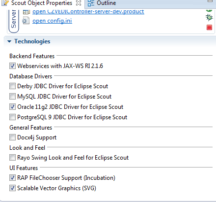

And my technology selection are:
index.php/fa/19424/0/
