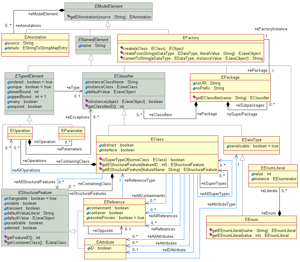

I am defining a new extension to gastm for a 4GL language. I need to create some enumerations with some literals. In gastm there are EnumTypeDefinition, EnumTypeDeclaration, EnumLiteralDefinition and EnumLiteral
In emf I declare an enumaration like this:
<eClassifiers xsi:type="ecore:EEnum" name="TextType">
   <eLiterals name="Functional" value="0" literal="F"/>
   <eLiterals name="Help" value="1" literal="H"/>
</eClassifiers>
How should I translated it in my ecore file?
Martin
Re: Enumeration in an extended gastm [message #1439854 is a reply to message #1439825] Tue, 07 October 2014 11:46 Go to previous messageGo to next message
In EMF, there is no declaration/definition distinction.
An EEnum is an EDataType and so an EClassifier (such as an EClass is also).
Thus, to create your new enumeration type you have to use an EEnum, each different literal being an EEnumLiteral.
index.php/fa/19408/0/
If you want more details on this Ecore thing, I guess the EMF forum would be a more suitable place.

So then you should probably extend the current GASTM definition in Ecore by creating some new EClass(es) inheriting from the EnumTypeDefinition, EnumTypeDeclaration and so on.
In this case, this is really more a GASTM problem than an Ecore one and only the spec (or related documentations) should be relevant in this context.
