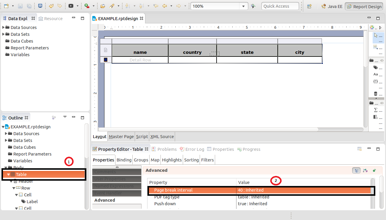

Re: Birt 4.4 Excel Emitter to single sheet excel export [message #1765159 is a reply to message #1413242] Wed, 07 June 2017 03:31 Go to previous messageGo to next message
In order to avoid multi tab creation of records in excel sheet,set the page break interval correctly
1.In Outline ,select Body -->Table
2.In Properties,Select Advanced -->Page break Interval
Example:
If Page break Interval is set to 40, then after 40th record in table it migrates to next sheet.
