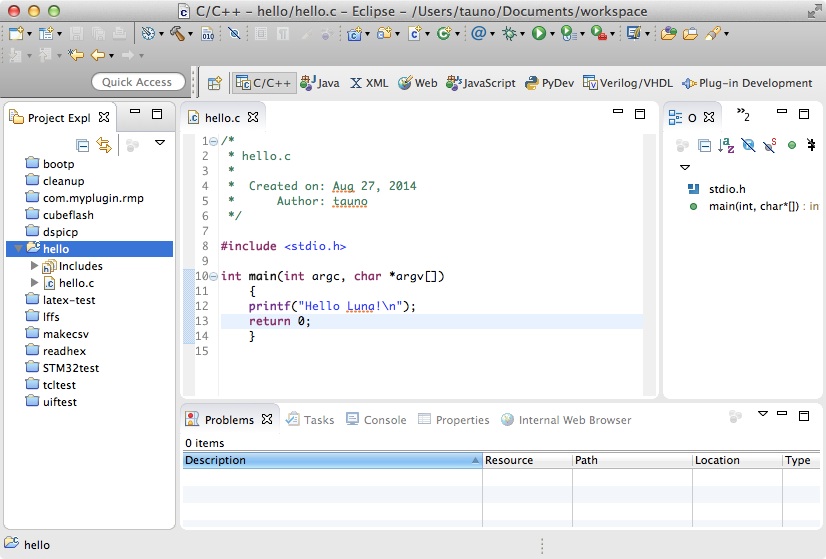

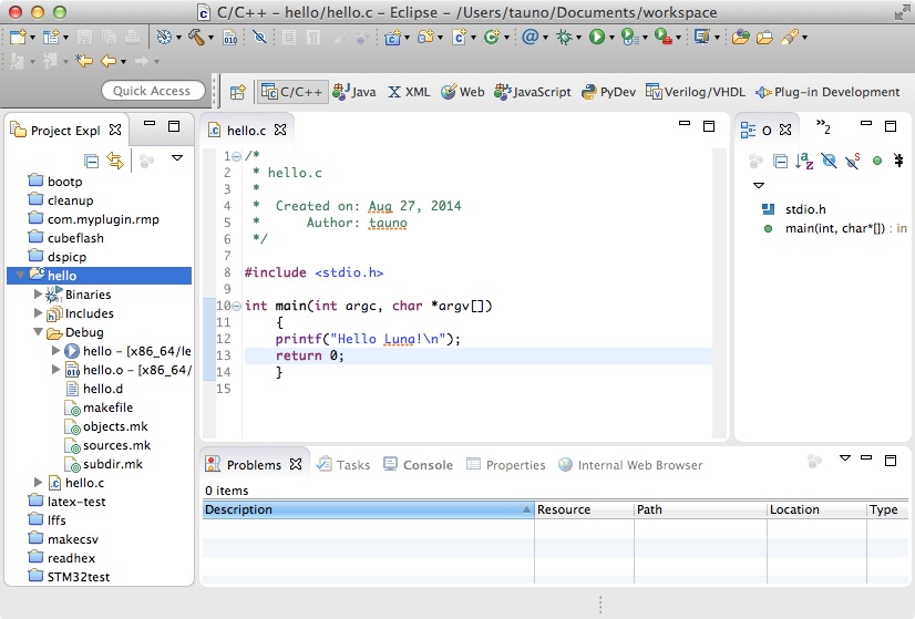

I had to create a fresh C project for hello to check (Luna 4.4.0, 20140612-0600).
Here is the Eclipse window before first build:
index.php/fa/18948/0/
Here is the Eclipse window after first debug build:
index.php/fa/18947/0/ Attached are two screen captures:
I just wonder if your setup has some settings gone fishy.
Re: the automatically generated makefile [message #1412861 is a reply to message #1412859] Wed, 27 August 2014 04:44 Go to previous messageGo to next message
Sorry, the forum switched the images, please regard as built image first.

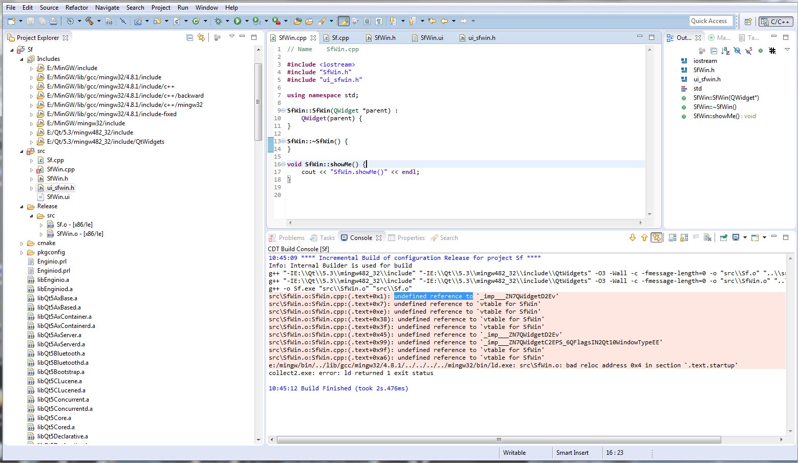

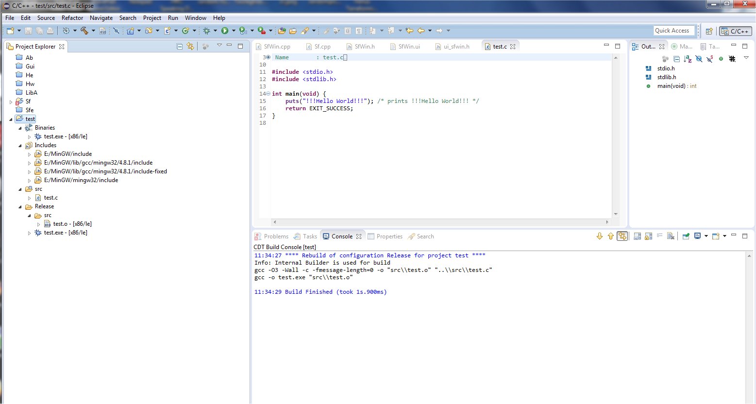

I tried to create a C Hello World project named "Test", just like yours.
This is what I got :
index.php/fa/18951/0/

The workspace preferences are found in Window -> Preferences (Eclipse -> Preferences in OS X).
The project preferences are in Project -> Properties.
It seems to me that you're using cmake instead of GNU make. Out of curiosity, have a look at the cmake subdirectory.

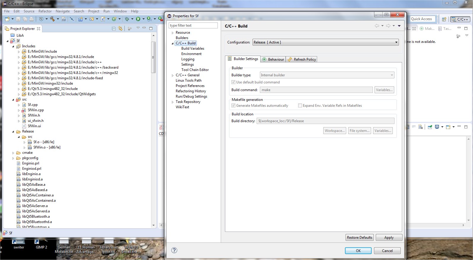

This is the menu I have when I select properties from the context menu of my project and select C/C++ Build on the left-hand tree.
In this menu under the tab Builder Settings is the textfield Builder Type. !! It is blocked from entering anything. The two other tabs I have, 'Behaviour' and 'Refresh Policy' are not depicted in the help file image.
It has Internal Builder and no other options.
index.php/fa/18963/0/

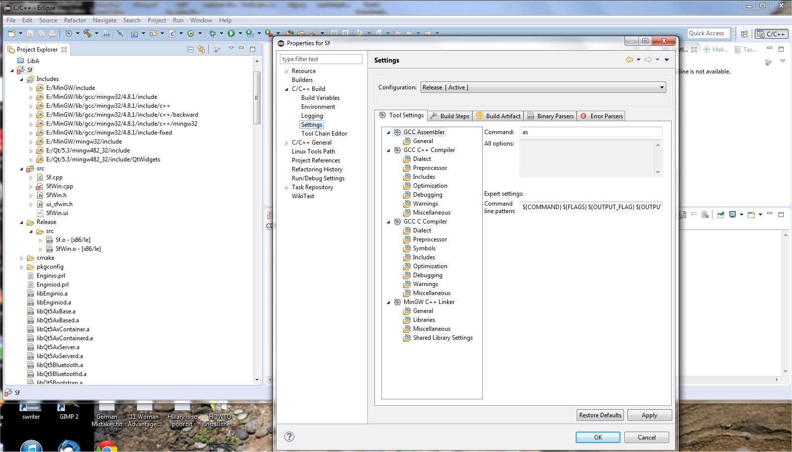

The second screen shot is from C/C++ Build/Settings on the left-hand tree.
Here nothing resembles 'Builder Type'
index.php/fa/18964/0/

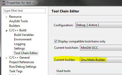

You can use "Executable project", but then you must switch the "Current builder" within the properties once (and therefore i forgot that...).
index.php/fa/18980/0/
After changing the setting to "Gnu Make Builder" you can go back to the other dialog and switch the setting between internal and external builder.
Do not ask me why this is necessary, i don't know. CDT settings are tricky Crying or Very Sad
