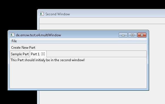

This is the result if I start the command:
index.php/fa/18808/0/

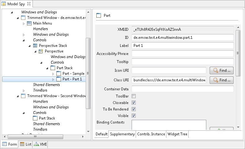

Digging deeper into this issue I created a target platform including the needed pde and jdt bundles to drive the live editor and I could verify, that my assumption is correct: The new part is added to the main stack instead of the one that it should be.
index.php/fa/18815/0/
