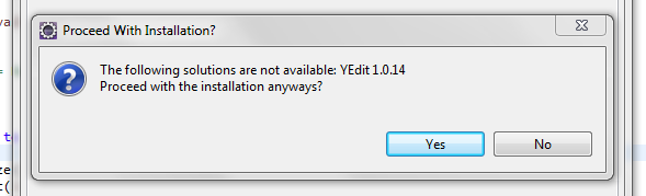

index.php/fa/22575/0/
I think I'm seeing the same message while trying to install the "Yedit" YAML editor through the market place. Is there a similar problem here?
  • Attachment: Capture.PNG
    (Size: 19.82KB, Downloaded 4679 times)
Re: Installing in Luna CDT problem [message #1705660 is a reply to message #1702168] Tue, 18 August 2015 04:32 Go to previous messageGo to next message
Hi!
It is possible, though to be sure it is required to check the project properties on Eclipse Marketplace (and that is up to the project's team).
