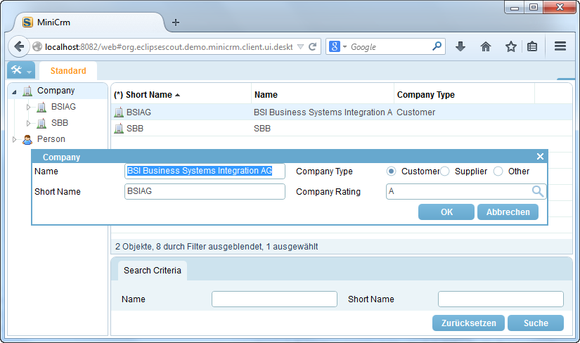

You are right, for web application URL is really important. If we take the mini-crm Demo application as example, it is absolutely natural to be able to create deep link into the web-application:
http://localhost:8082/web/StandardOutline/Company/
http://localhost:8082/web/StandardOutline/Person/
And even: http://localhost:8082/web/StandardOutline/Company/BSIAG/ to open the edit CompanyForm as dialog (as if the user has clicked on Edit)
index.php/fa/18508/0/
I am afraid that for the moment there is no possibility to achieve this out-of-the box with scout.
I think a workaround is to work with Scout Bookmarks, but I never did it, so I am not sure.
  • Attachment: mini_crm.png
