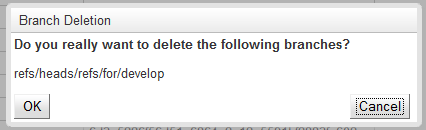

With your input, I was able to find where my commit went: orion created a "refs/for/develop" branch.
In the Gerrit admin I also see this branch and I can delete it.
index.php/fa/18505/0/
I have have tried to enter "/refs/for/develop" (with the leading slash). I got this error:
index.php/fa/18506/0/
Why does Orion add a "refs/heads/" prefix?
