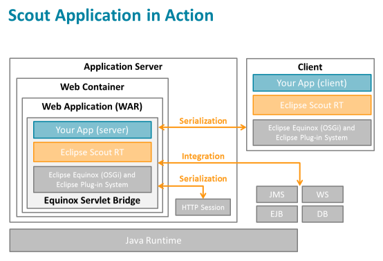

This conversation reminds me of a slide proposed by a coworker to illustrate how a scout application is running:
index.php/fa/18716/0/
The orange arrows represent connections to another system (from a server point of view). Sometimes the integration of the different system is difficult (it depends of the project you are involved in).
