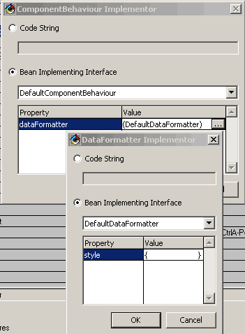

VCE of VisualAge for java has two PropertyEditors that we miss in VE
1. a generic PropertyEditor (CellEditor) for type Object that allows to
enter any code strip as String (new MyClass(), "anyString", etc.)
2. a PropertyEditor (Dialog) for interfaces that lists all implementors in a
ComboBox or alternatively allows to enter a code string (see attached
picture)

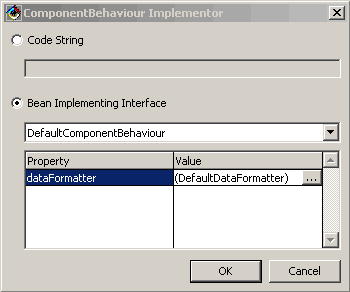

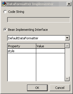

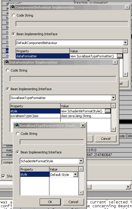

> implementors in a ComboBox or alternatively allows to enter
> a code string (see attached picture)
In this case we have the same "problem" as mentioned before. In additon to
this we don't have the ability to get all implementors of an Interface with
code assist (or am I wrong?). Further, the PropertyEditor dialog of VCE of
VAJ was able to list all propertis of the current selected implementor
evaluating the BeanInfo of the selected type (each implementor has a
different number of configurable properties defined in the concerning
BeanInfo). If one of this "nested" properties was an Interface itself you
got another PropertyEditor dialog (same type of PropertyEditor) to configure
this... and so on (see attached pictures).
