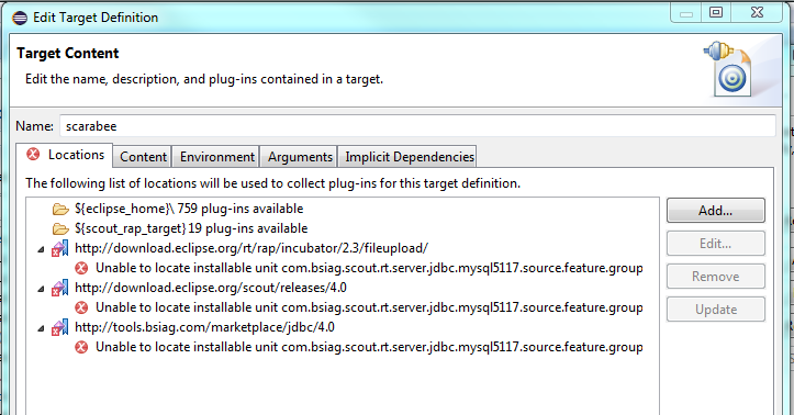

In Luna if I open my target definition (the one that is automatically created for my project) I see some errors there.
Any idea how to fix these?

Re: RAP FileChooser [message #1393118 is a reply to message #1393087] Thu, 03 July 2014 05:07 Go to previous messageGo to next message
If I enable an option in the technologie section the target definition is changed. When I enable more then two options in the technologies section then things seem to be messed up in my target definition.
If I open the targetdefinition in a text editor I don't see any problem there but when I open it in the target editor it shows me errors. No idea whats causing it yet.

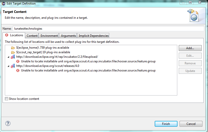

Re: RAP FileChooser [message #1393232 is a reply to message #1393118] Thu, 03 July 2014 09:14 Go to previous messageGo to next message
Just tested with a clean (Luna) installation. Created a new project and only selected technologies. As soon is I selected the third one (first mysql, then rayo and third RAP filechooser) the target definition shows errors.
Can someone confirm on this ? Is it a bug or some other configuration thing.
Regards Bertin
Re: Luna technologie RAP Filechooser problem [message #1395704 is a reply to message #1393232] Mon, 07 July 2014 05:19 Go to previous messageGo to next message
Bertin Kiekebosch wrote on Mon, 07 July 2014 10:25
when I enable the RAP Filechooser (Eclipse Luna) in the technologies section and go to the target definition it is indicating a problem. Is it a bug?
index.php/fa/18483/0/
I could reproduce it on my machine. Thank you for your feedback.
It seems to me that the Scout SDK is not choosing the "org.eclipse.rap.fileupload.feature.feature.group". I manage to solve this by editing the target file with the target editor:
* select the "download.eclipse.org/rt/rap/incubator/2.3/fileupload/" update site node and click Edit.
* In the "Edit Content" Dialog check the "RAP File Upload Support (Incubation)".
* Press "Finish"
* Save the Target file (CTRL-S)
If you open your target file with a text editor, you should see:
<unit id="org.eclipse.rap.fileupload.feature.feature.group" version="2.3.0.20140517-1319"/>
The SDK created an entry with version "2.3.0.20140426-0831", when I installed the filechooser with the Technology checkbox.
Thank you for mentioning your problem here, I will check with the SDK developer to understand why this error occurs.

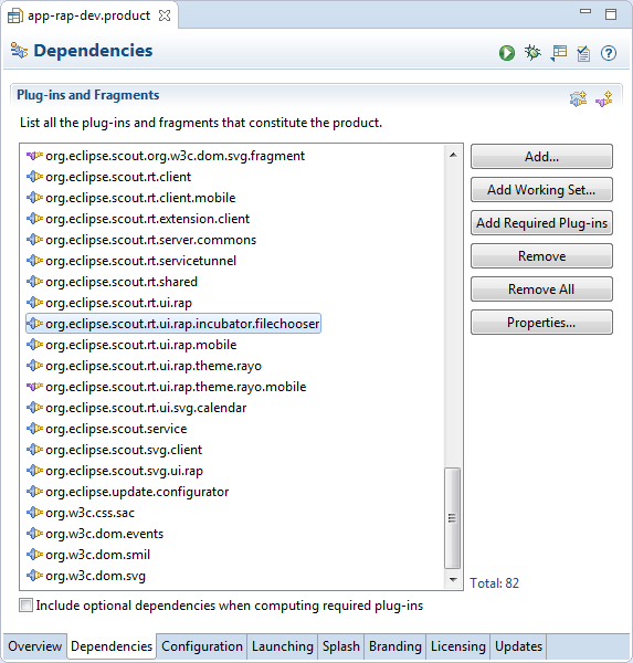

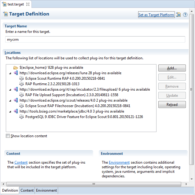

Re: Luna technologie RAP Filechooser problem [message #1696234 is a reply to message #1695574] Sun, 24 May 2015 05:21 Go to previous messageGo to next message
I have checked your target file, it is working in my Eclipse IDE (Luna version):
index.php/fa/21918/0/
After having clicked on "set as Target Platform", I can add "org.eclipse.scout.rt.ui.rap.incubator.filechooser" to the RAP product file:
index.php/fa/21919/0/
You also need to ensure that your product file validates (see also this problem with the Mars version: Scout M7: Require-Bundle: org.eclipse.rap.fileupload).
I also recommend you to read this message where I have tried to explain target-platform, target-definition, product file...
